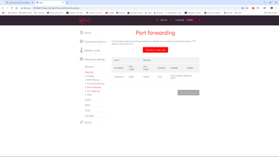

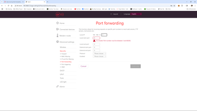

I have just upgraded my NAS from a Synology DS718 to DS723, believing this would be a simple swap out task and to an extent with was until I discovered the device could not be accessed externally, due to Port Forwarding Issues. For some reason, the Rules for the NAS are already set via UPnp, presumably linked to previous NAS. Also, when I attempt to change the details in the Local IP box and error message appears. (see screenshots)
Does anyone know what the issue is with my Hub and how I might work around the problem. All assistance would be welcome.

    Delete all rules and start again or do a pin-hole reset to the hub.
  • legacy1's avatar
    legacy1
    or get a better router and use hub in modem mode
