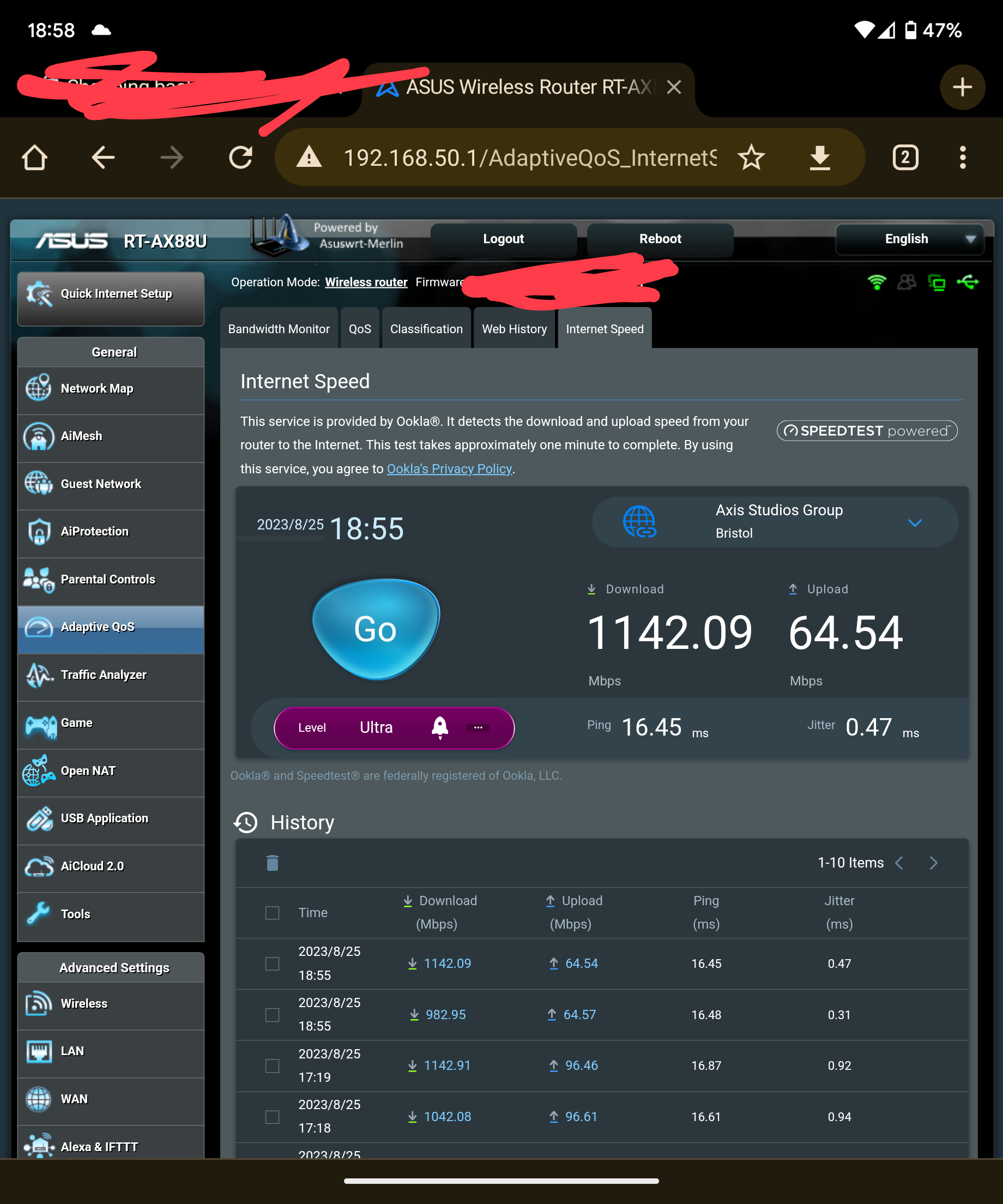

    Please don't spread false information.  As I said I use a undocumented feature as my router don't have the 2.5gb port, but I still have full speed.  When VM kills the load balance on the super hub 5 I will be getting the ax88u pro as it has the 2.5gb port.
    Here's a screenshot of my current speeds with VM

      I'm intrigued by this since the Asus routers generally don't support rr, just bonding (802.3ad)?
      Does the Merlin firmware give you more options?
      • AaranAdams's avatar
        AaranAdams
        It's always been a feature in Asus software (depending on the router).  It's just hidden in the wan settings.  It also has wan aggregation, but the hub 5 does not support this, well I can not get it to work.
