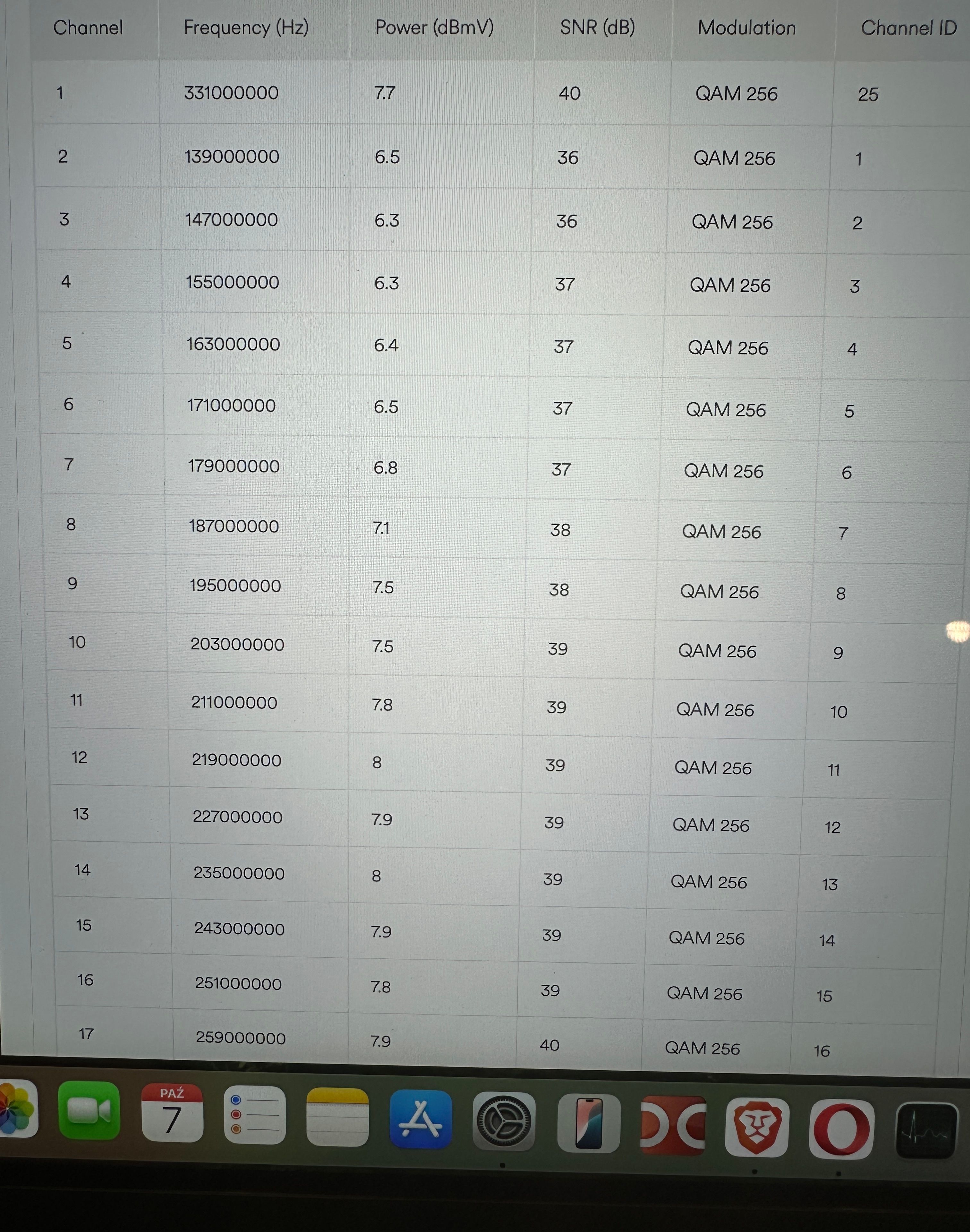

  • I got problem with hub 5 after upgrade contract from hub 3.
    Costant rebooting every 5 minutes.
