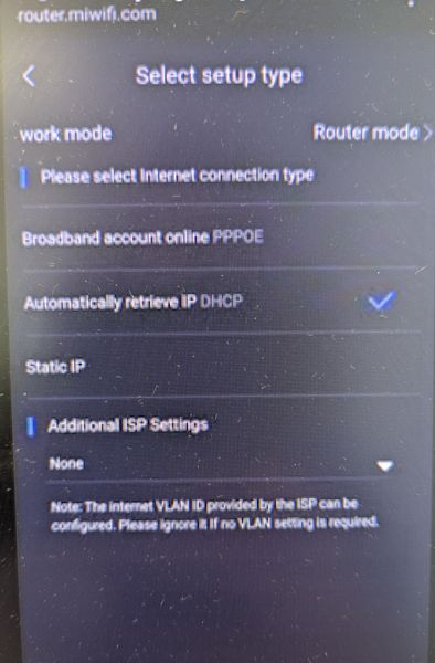

        Vm don’t use PPPoE so you need to change that.
  • Roger_Gooner's avatar
    Roger_Gooner
    You'll find that in addition to PPPOE will be at least one other option such as Dynamic IP or DHCP, so choose it. Now reboot your router.
  • I assume the blue tick means it's using DHCP and  assigned IP.  Is there anything else under additional ISP settings ?  The other thing could be to factory reset and run setup when connected to VM hub in modem mode ( as your post implies you've set them up and connected to the VM hub on router mode but maybe I misinterpreted).  I find it easiest to reset / set up VM hub to modem mode is via a mobile connected to VM default WiFi so I can leave the rest of my network / PC untouched
