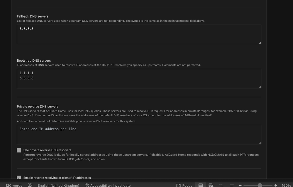

      I did try adding Virgin's DNS servers as a fallback DNS, but it didn't make any difference.

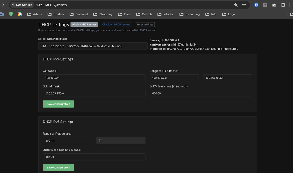

    Settings – DHCP (enable): My settings as below with the raspberryPi set to a static IP of 192.168.0.2 (outside of the range of IP addresses).

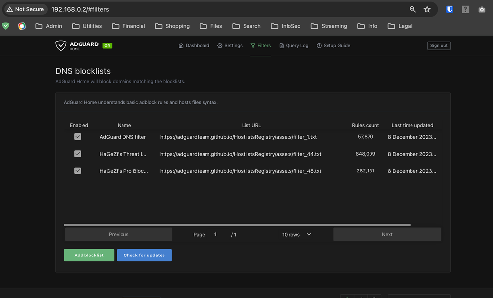

    Add required filters in Adguard. I got tracker + ad block and then a large threat intelligence database.

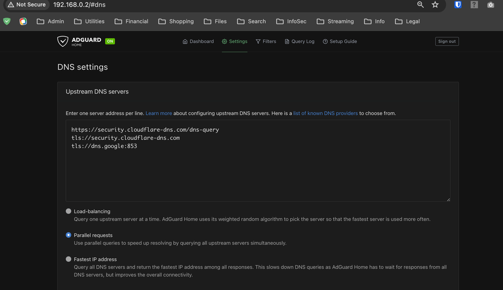

    Setup required DNS in Adguard (I opted for these SecureDNS). Find your optimal DNS servers using the DNS speedtest: https://dnsspeedtest.online/

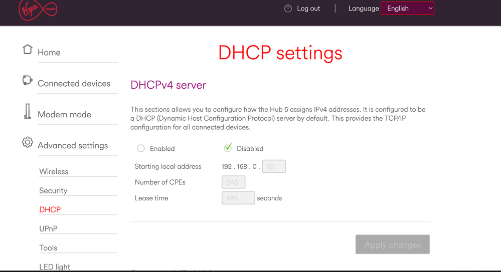

    On Hub 5 go to admin console 192.168.0.1 and login
    Advanced – DHCP – Disabled
    Now devices will get pushed to the AdGuard DNS and receive IP via Adguard DHCP server. & you are away.

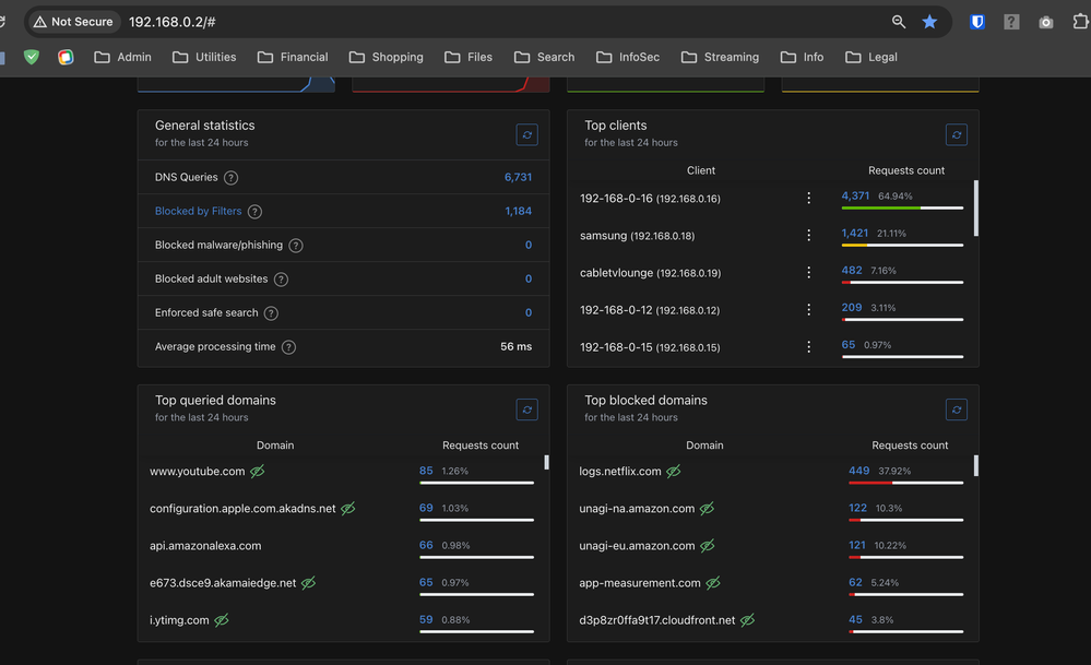

    I ran this over a year without issues previously. Example of it blocking:
    Considering my £20 ebay Rasberry Pi 3b+ had been in a draw for over a year, it gives it some life back. Cheaper than a new router, some nice features to block ads etc natively. I also opted for the cloudflare DNS that auto blocks security risks (layering up on security). For me google DNS is always much slower so it serves as a backup only really.
