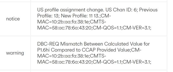

I receive this in logs roughly every ten minutes. Not sure what it means or if it's a problem

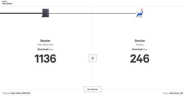

5ghz when working
5ghz most of the time

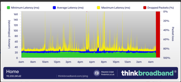

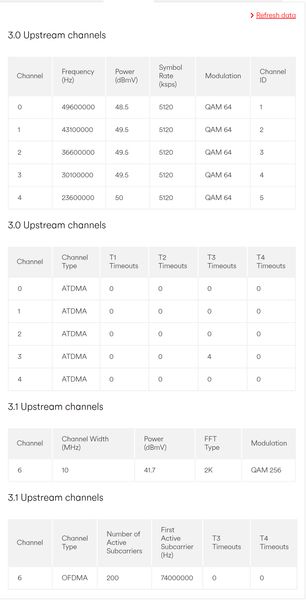

    According to all the data you have posted, the broadband feed to your Hub is working normally. The problem with your WiFi is within the house.

    Agree with jpeg1​    Stats and Samknows all look fine.  So that's either a faulty Wifi device or the Hub's failing?  Could be environmental, but that's hard to pin down if it is intermittent.

    Seeing 246Mbs on the 2.4GHz band is almost 200 faster than we normally expect.
    That test performed like a connection at 5GHz.
