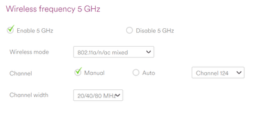

However my 5G network is nowhere to be seen? I have rebooted the router via the GUI and the switch at the back, still nothing.
So what has gone on with this hub please?
  • Wi-Fi channel 124 is a DFS channel. That means when you enable the 5GHz band the Hub spends some time listening for conflicting radar broadcasts on that channel.  But the service should start in under 10 mins.
    Try changing the channel to 36 or 44 and the 5GHz Wi-Fi service should start more promptly.

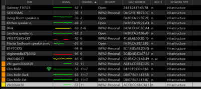

    I reloaded that and still cannot see the 5GHz in InSSIDer. Network name went back to same as 2.4G.

    Plus my hub is only giving out n, when the other VM hubs are giving out a & c ?
    In the SSID scan shown above the Wi-Fi channels covered are only from 1 to 11,
    these are all on the Wi-Fi 2.4GHz band which does not support either 802.11a or 802.11ac
    802.11a and 802.11ac are only supported on the 5GHz band,
    which are channel number from 36 & above.
    Is there a filter in place that is limiting the view to the 2.4GHz only
    or is this info from a computer / mobile with a 2.4GHz only Wi-Fi adaptor ?
  • No, the inSSIDER is from my laptop which has a Broadcom BCM4352HMB 802.11ac 2x2 Wi-Fi Adapter

    I have not played around with the hub much at all, certainly not changing channels. So the 5G has always been on 124. I do get warnings when I go manual abour 124 being DFS, which means nothing to me, as it has always been that.?

      I have selected Disable Channel Optimization so as to be able to make changes.
