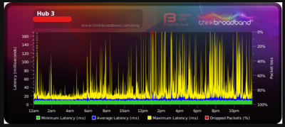

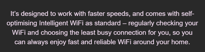

    What's this all about on the Hub 4 though - is it reason to switch to the Hub 4:

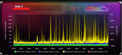

    And, if I did switch to the Hub 4, would it cure any of these graphs:
    • jbrennand's avatar
      jbrennand
      In the first post you said everything was fine.   So what issues are you experiencing now ?  So do the graphs actually need "curing" - of what ?

        I don't actually have any issues (its only my laptop connected directly via a wire) if I'm honest but have always been aware that my graphs have always looked like the ones I posted.
        Does that even matter ?

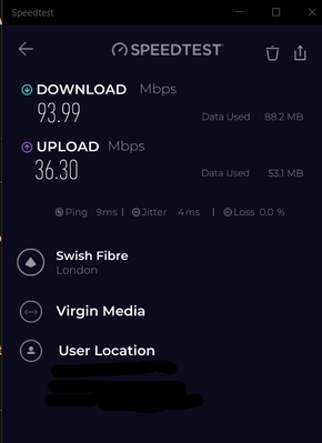

  • I've just done a few speed tests on a wired connection from my laptop.
    Speed Test app shows this:
    But on the Sam Knows Speed Test, it shows this:
    Why is there such a massive difference ??
      Hi again deans6571
      The first thing I would do is check the settings of the network card.
      Seeing as SamKnows shows you are getting full speed to the router and the download speed to your desktop is below 100Mbps it would suggest that your network card Speed & Duplex is set to 100Mbps rather than 1.0Gbps.  Double check that first and change it to 1.Gbps if needed.
      If that isn't the case then I suggest trying a different ethernet cable if you have one, or failing that a different ethernet port.
      EDIT - Sometimes speed can be affected by anti virus programs and also using a VPN. Also the browsers used in testing can show different speeds. On my PC the speed is nearly always faster if I use Edge browser instead of Chrome .

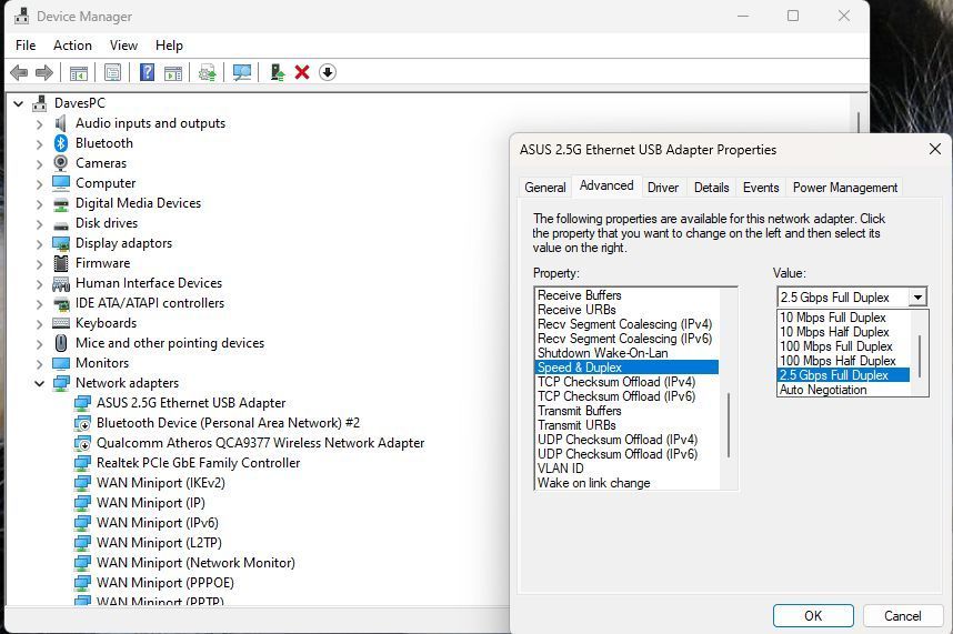

      speed and duplex

        newapollo wrote:
        Hi again deans6571
        speed and duplex
        Mine is set to 'Auto Negotiation' or something like that. The highest option is 1.0Gbps - there is no option for 2.0gbps. Should I set it to 1.0 gbps?
        Also, I just did a second Speed Test and its now showing around 380Mbs - perhaps the earlier one was a blip?!
  • jpeg1's avatar
    jpeg1
    This is the classic result of the ethernet link speed between Hub and client dropping to 100Mbps.  Try a different cable, and check the ethernet settings in the laptop.
