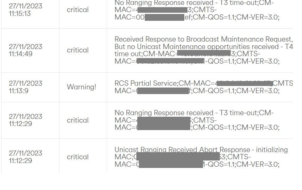

      In the meantime...   There`s about 20 entries in the network log area, spread over the past 3 days. All are either .. `LAN login success` ... No ranging response `  or  RCS partial service.....    But these 5 ( see pic) from the 27th also mention  ` Unicast `  and `maintenance `.        I have blanked out MAc numbers.   ...................  ?

      This from another one of my posts a few weeks ago..  This is what`s making me think fault....
      Plus.. the words " warning "   Critical "  Partial service "   etc in the logs....all seem a bit worrying to someone like me who doesn`t understand the lingo.   Even the basic things like ...`.why would the ethernet connection ever change from 1000 to 100...what makes it change ?  `  I really don`t understand.  It`s hard to understand things like....why I would get a better connection/ download speed on the new Tv, via wifi connected to a pod miles away, than I would when connected direct via ethernet,   Just seems ridiculous to me.

  • 'Critical' should be rarely seen.
    'Warning' is a bit of an overlap of what's recorded. Some are nothing to worry about, some indicate an issue with your line or the local area.
    • JohnUK777's avatar
      JohnUK777
      Thanks Carl.   As I look now at 9-20pm ) The log appears to go back 7 days. The last entry being 8-50am today)  In that 7 days there are 20 entries in the "priority " column.
      8 are listed as " critical "  ........ 2 are " warning"   .
      The other 10 are " notice " ( which all say "LAN login success ")
      So not exactly sure if 8 "Criticals " in a week is considered " rare " .

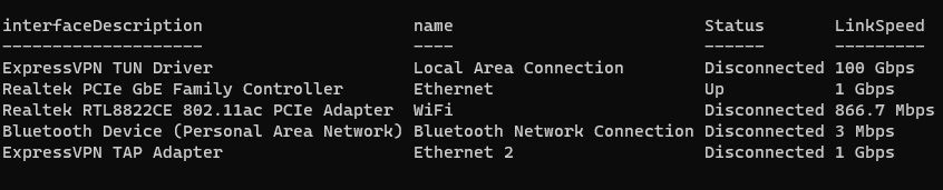

    open Windows PowerShell and run this
    Get-NetAdapter | select interfaceDescription, name, status, linkSpeed
      JohnUK777
      You`re losing me Legacy.   Too advanced for me.  😃
      Thanks for link, but it`s all beyond me I`m afraid...   No idea what EEE and green power is.
        Anyway....   Windows update and built in HP support assistant reports all drivers are up to date and latest ones.  It`s a brand new W11  HP pC.

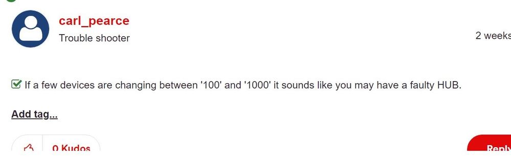

  • Assuming you have tried another ethernet cable, and taking into consideration if affected another PC, I can only come to the conclusion you have a faulty HUB.
      JohnUK777
      Thanks again Carl.    I came to that conclusion weeks ago.😃.... ( In my head ) ...   But just wanted to double check with you guys before I go to the trouble of trying to explain the problem to someone in Phillipines who won`t understand a damn word I`m saying.
