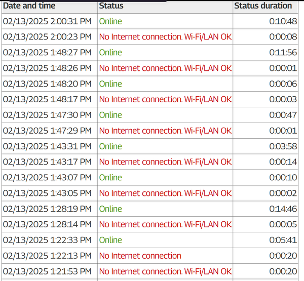

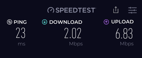

  • Was trying to listen to a one hr podacst, between 1300 & 1400 dropped the connection 13 times.
    The grid and speed test do not give any clues as to where the speed / connectivity is being lost.
    Share a screen shot of the Full Test from :
    Once the test begins click on: Run full test to include: Latency, Jitter, Packet loss & Upload speed.
