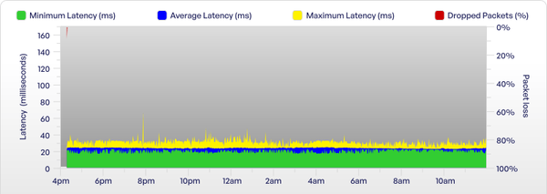

    Terrible connection, looks like noise ingress somewhere.  Downstream power is also on the high side.  Have you a BQM running to record the connection performance?
  • Thanks, I'll get on to that. I've never used the tool. How long should I record for?
