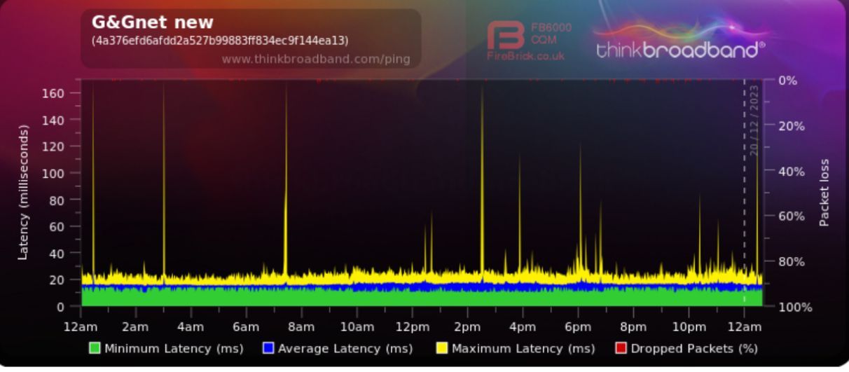

    Could you set up a 'Broadband Quality Monitor'. This will monitor the state of your connection and record any network dropouts etc
    Give it a while to gather data and then click 'Share Live graph' and paste the 'Direct Link' into the forum

        Thanks for providing this graph. I've ran some checks on our side, and can see that your Hub has been online for 28+ days, can you please perform a reboot by switching it off at the back, waiting for 30 seconds and then switching it back on again?
        Over time, the Hub can cache data and cause problems with the onboard system memory. As it does this, similar to other devices and this can cause a knock-on effect for other internal electronics, which can begin to cause issues as in some cases, the signals we are sending cannot be read or actioned.
        Rebooting the Hub will also force any updates to your equipment, which can improve the service.
        Please do let us know if you experience any issues after rebooting, and we'll do our best to assist further.
    • djgeurn's avatar
      djgeurn
      https://www.thinkbroadband.com/broadband/monitoring/quality/share/99b66352b1b9591d75cbc6ef1773a1deecc32f98-20-12-2023
