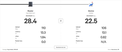

So I recently swapped to GIG1 and was sent a hub 5 on Tuesday. After setting it up I did a samknows speed test and saw that the router was only receiving anywhere from 30-40 Mbps.
After calling virgin media they said to give it time to kick in but it is now just about to turn Friday and there is no improvement at all.

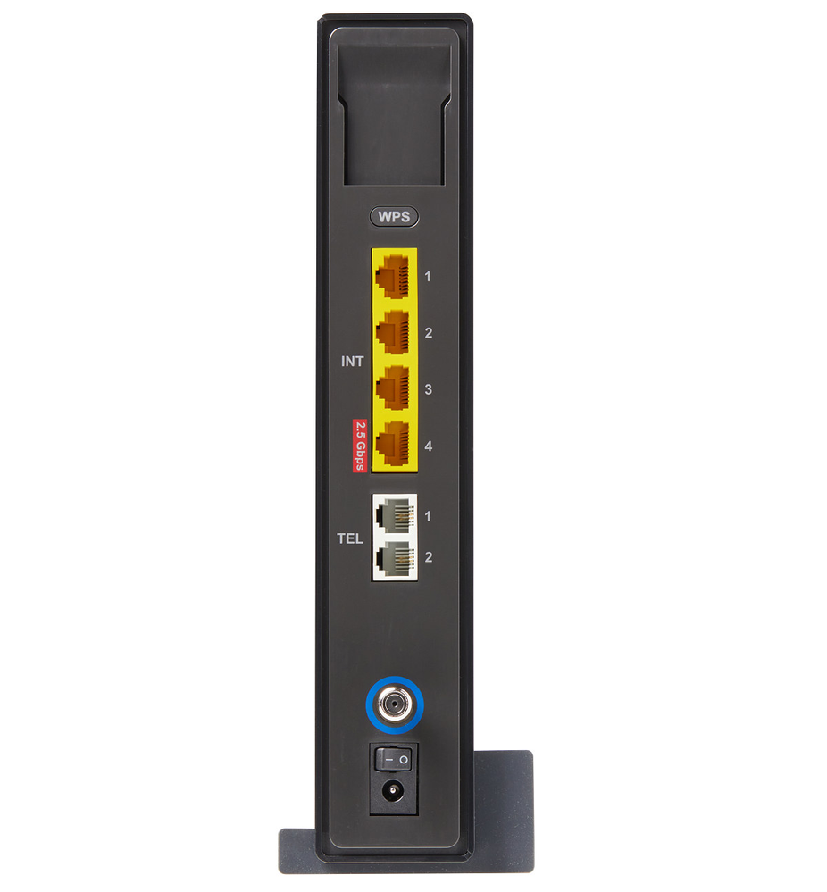

      Okay so this might come across as a dumb question but like where did they put the pinhole reset on the hub 5 cause like on my old hub I can clearly see it but on the hub 5 its no where to be found
      • Geoz123's avatar
        Geoz123
        Nvm I found it as its now on the bottom of the hub
  • Well after doing the reset nothing has changed so hopefully when ever I next get into contact with virgin they will have more answers.

    The 28.4 Mb/s Downstream to the Hub is a service problem in the VM Network serving your street.
    If you look in the Downstream status tab there may be a clue of the nature of the fault.
    Call automated number 0800 561 0061 to see if this is a known issue for your street.
