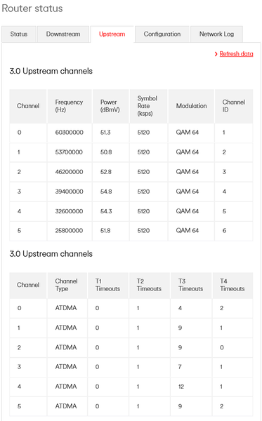

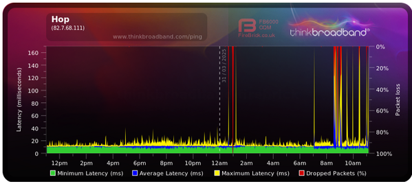

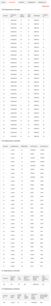

Hi everyone, I've had this issue and was "solved" like 10 days ago, which seems to be back. and I cannot figure this out. Any help is appriciated.
  • Using HUB5 (router mode)
  • Initially problems started 2-3 weeks ago
  • I've no changed anything that could cause these on my side (no settings, HUB cable connection etc, it didn't even move basically)
  • All devices are being affected (both cable and wireless connections or 2.5ghz or other sockets doens't matter)
  • Last time this happened / 10 days ago, suggested "power off hub for 5 mins" had worked, but its back once again.
As understanable, I cannot just power off HUB and keep having these issues. Not sure if its cable / socket or hub issue whatever but this is getting annoying. Please find the all information below both with the old thread and the screenshots of the new issues. Thank you all.

    looks to be noise on the upstream caused by someone with a bad line
