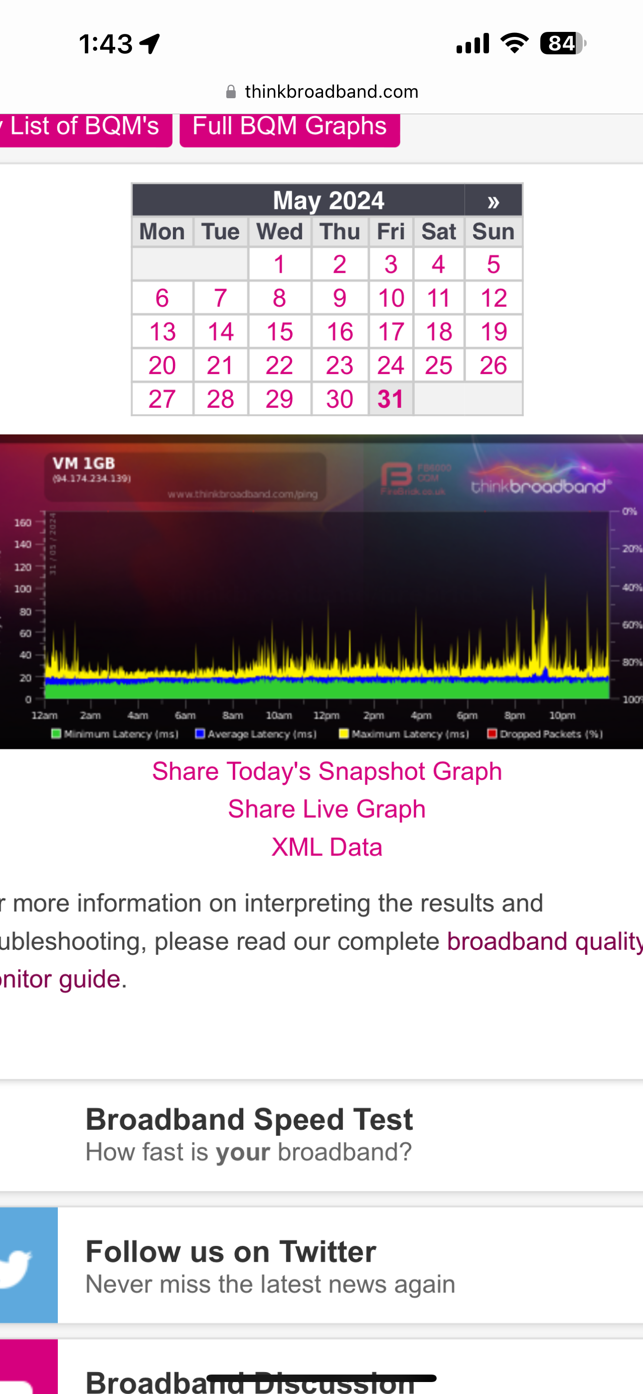

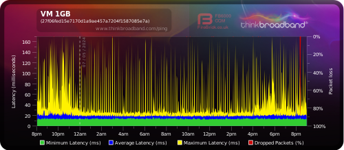

  • Thanks for the reply. Appreciate the time and effort.
    just looked again, 3.1 channel is constantly rising with pre and post errors. All other channels absolutely fine and zero. Been like this for a few weeks, didn't really notice it because the primary WAN was failing over in the background to the 4G connection and my alerting stopped working from telegram.
    3.1 Downstream channels
    Channel ID Locked Status RxMER Data (dB) PLC Power (dBmV)
    Corrected errors (Active Profile) Uncorrectable errors (Active Profile)
    159 Locked 36 2.8 2565890714              47437
    More in the network referring to error codes 16 & 24

  • Multiple engineers and still no fix in sight. One of the engineers did find a ‘nick’ in the coax half way down the ducting and repaired this. Seems to have stabilised the connection somewhat… few weeks after this, back to frequent packet loss and the latency had gone really poor again. This can be shown in the screen shots. The lower latency was just after the nick in the cable was fixed, still had packet loss though. And the other screen shot is from now. Ironically, no one is at the house as the moment and it’s just all over the show. Constant alerts from my firewall advising the main WAN connection has failed over to my 4G backup. If you look carefully at the top, you will see little red dots frequently which indicate communication loss to the modem.
      Hi monks600
      Sorry to see the problems still existing.
      You need to repost the BQM's with the IP address redacted. Pictures are declined as they show your IP address.
      You could also set up a live BQM which automatically redacts the IP address and prrovides continious updates (it wil take a couple of hours to start showing the results)
      On Think Broadband go to your  BQM and under the options you will see
      Today | Previous Days | Edit | Delete | Share
      Click on the Share option and on the screen that opens click on Share
      On the next screen click on Share Live Graph
      Copy the text in the Direct Link box (beware there may be more text than you can see so make sure you highlight it all)
      On here when creating your post click the Link icon (2 links chain to the left of the camera icon)
       In the URL box paste the link you copied and then click OK.
