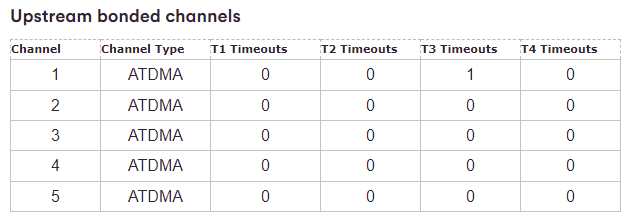

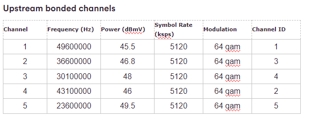

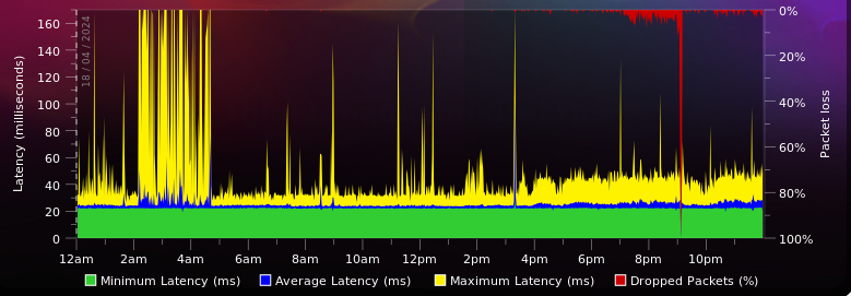

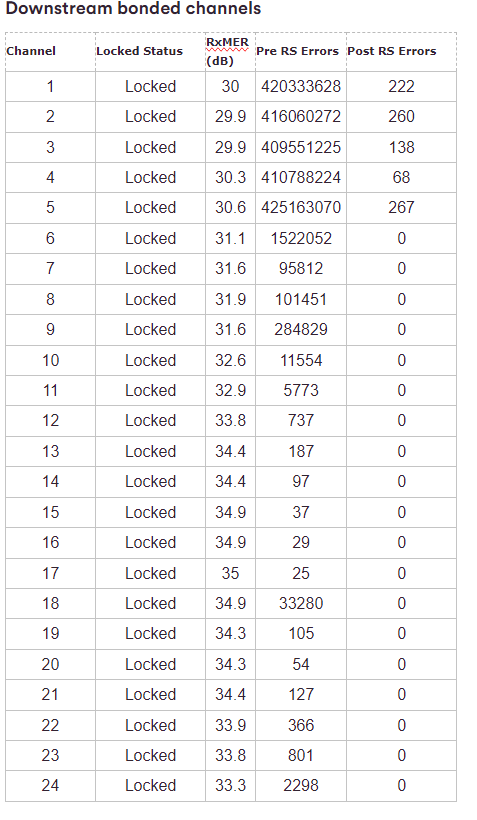

Hey, I have been experiencing extreme lag almost all day but especially from around 3pm onwards, All devices wired and wireless, usually all evening. Have done all the usual cable checks etc. Can't seem to get an idea of what is happening myself from the router or anything like that. Virgin broadband checker says there's no issues in my area but when I click still experiencing issues I get given the: "Looks like there’s an intermittent signal issue in your area". It has said this for weeks every time I check with no status changing. Will post router stats and BQM below, seem to be getting lots of packet loss and huge spikes, the internet doesn't seem to drop but is really quite unusable a lot of the time, please help

Most days look very similar to these graphs:

  • Call it in as a fault. Your downstream power levels are far too low and you have lots of post RS errors on some of the downstream channels.

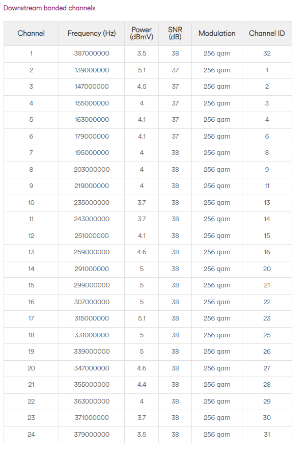

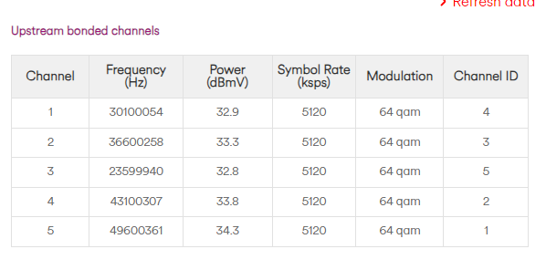

  • An update: Technician came, agreed the connection was terrible and was surprised our internet was even online. He then called for another technician to come sort out the power levels. I believe the second guy actually went to a few street boxes because I saw him drive off from ours and could see him doing multiple maintenance requests in the logs around 20 mins apart from each other. Anyway here are the current levels :
    MUCH MUCH better and have had zero issues since the fix on Wednesday. Mostly just posting this so I have evidence if it happens again or if it helps someone else (hopefully avoid useless off and on again advice for others), but thanks for the help all. 😀
