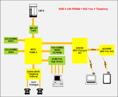

OK - so WiFi works. You also said that a factory reset fixed it temporarily. This suggests that the Ethernet switch section works. But what could have happened when it goes down? Is the Hub 3 warmer/jhotter than you would expect in which case the chip driving the switch is running hot after a while? Does that make sense?
The joy you should receive from the Forum Team is a tech visit to change the Hub 3 (which is in any case a crap device). It has a weak CPU, borrows processor power from other chips, has a tendency to overheat and is very bad news if you read the forums.

Hub 3 Block Diagram
Assuming the mods clear the picture, I've pasted the block diagram for the Hub 3 showing the comp[onents and their relationship. Just thought you might be interested.
