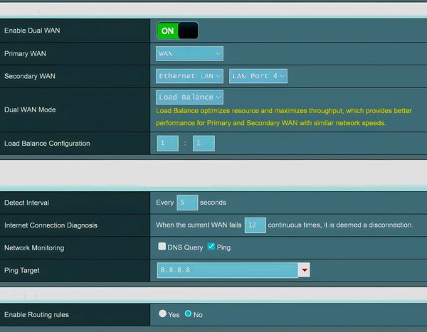

Hey guys, quick question, I'm currently with BT/EE and thinking of getting a Virgin package in as a failover line. Just wondering do I put the modem in modem mode while doing this or just keep it in router mode. I have an Asus router which supports failover and Dual Wan and can configure say Ethernet 4 for failover or load balancing.

  • Yes, I did this for a while until my VM contract expired. You need to have the VM router in modem mode to avoid dual NAT.
    You need to check that VM won't be giving you a full fibre connection with a Hub 5x Hub, because that can't be set to modem mode.

    Yes, I had a DualWAN setup for work redundancy with VM and BT.  Hub in modem mode as noted by jpeg1​    Worked very well, both circuits running concurrently as load balanced.
