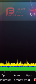

Dropouts, T3 timeouts, dropped packets. Escalation needed asap
Forum Team please escalate it to Network Team or something because I had 5 engineers already and they were just changing coax cable, wall box, hub and all the nonsense. I need someone who look outside of the property like in the street cabinet and finally fix that
So please do not mention here things like "WiFi", "check connections are finger tight", "reset hub" etc. etc.
And most likely this is an area problem because I used to live on a different street which is about 0.5 mile from my current house and that house was also affected by the same issue and this has been going on for years
04-01-2024 16:34:04critical16 consecutive T3 timeouts while trying to range on upstream channel 8;CM-MAC=**:**:**:**:**:**;CMTS-MAC=**:**:**:**:**:**;CM-QOS=1.1;CM-VER=3.1;
04-01-2024 16:29:39criticalStarted Unicast Maintenance Ranging - No Response received - T3 time-out;CM-MAC=**:**:**:**:**:**;CMTS-MAC=**:**:**:**:**:**;CM-QOS=1.1;CM-VER=3.1;
04-01-2024 16:29:23noticeCM-STATUS message sent. Event Type Code: 5; Chan ID: 10 11 12 13 14 15 16 17 18 19 20 21 22 23 24 26 27 28 29 30 31 32 33 34 35 36 37 38 39 40; DSID: N/A; MAC Addr: N/A; OFDM/OFDMA Profile ID: N/A.;CM-MAC=**:**:**:**:**:**;CMTS-MAC=**:**:**:**:**:**;CM-Q
04-01-2024 16:29:23noticeCM-STATUS message sent. Event Type Code: 23; Chan ID: 41; DSID: N/A; MAC Addr: N/A; OFDM/OFDMA Profile ID: N/A.;CM-MAC=**:**:**:**:**:**;CMTS-MAC=**:**:**:**:**:**;CM-QOS=1.1;CM-VER=3.1;
04-01-2024 16:29:15noticeCM-STATUS message sent. Event Type Code: 22; Chan ID: 41; DSID: N/A; MAC Addr: N/A; OFDM/OFDMA Profile ID: N/A.;CM-MAC=**:**:**:**:**:**;CMTS-MAC=**:**:**:**:**:**;CM-QOS=1.1;CM-VER=3.1;
04-01-2024 16:29:15criticalStarted Unicast Maintenance Ranging - No Response received - T3 time-out;CM-MAC=**:**:**:**:**:**;CMTS-MAC=**:**:**:**:**:**;CM-QOS=1.1;CM-VER=3.1;
04-01-2024 16:29:15noticeCM-STATUS message sent. Event Type Code: 24; Chan ID: 41; DSID: N/A; MAC Addr: N/A; OFDM/OFDMA Profile ID: 0 1 2 3.;CM-MAC=**:**:**:**:**:**;CMTS-MAC=**:**:**:**:**:**;CM-QOS=1.1;CM-VER=3.1;
04-01-2024 16:29:01noticeCM-STATUS message sent. Event Type Code: 4; Chan ID: 10 11 12 13 14 15 16 17 18 19 20 21 22 23 24 26 27 28 29 30 31 32 33 34 35 36 37 38 39 40 41; DSID: N/A; MAC Addr: N/A; OFDM/OFDMA Profile ID: N/A.;CM-MAC=**:**:**:**:**:**;CMTS-MAC=**:**:**:**:**:**;C
04-01-2024 16:28:53warningTCS Partial Service;CM-MAC=**:**:**:**:**:**;CMTS-MAC=**:**:**:**:**:**;CM-QOS=1.1;CM-VER=3.1;
04-01-2024 16:28:26criticalStarted Unicast Maintenance Ranging - No Response received - T3 time-out;CM-MAC=**:**:**:**:**:**;CMTS-MAC=**:**:**:**:**:**;CM-QOS=1.1;CM-VER=3.1;
04-01-2024 16:28:25criticalNo Ranging Response received - T3 time-out;CM-MAC=**:**:**:**:**:**;CMTS-MAC=**:**:**:**:**:**;CM-QOS=1.1;CM-VER=3.1;
04-01-2024 16:28:22criticalStarted Unicast Maintenance Ranging - No Response received - T3 time-out;CM-MAC=**:**:**:**:**:**;CMTS-MAC=**:**:**:**:**:**;CM-QOS=1.1;CM-VER=3.1;
04-01-2024 16:28:21criticalNo Maintenance Broadcasts for Ranging opportunities received - T2 time-out;CM-MAC=**:**:**:**:**:**;CMTS-MAC=**:**:**:**:**:**;CM-QOS=1.1;CM-VER=3.1;
04-01-2024 16:27:58warningRCS Partial Service;CM-MAC=**:**:**:**:**:**;CMTS-MAC=**:**:**:**:**:**;CM-QOS=1.1;CM-VER=3.1;
04-01-2024 16:27:58criticalNo Ranging Response received - T3 time-out;CM-MAC=**:**:**:**:**:**;CMTS-MAC=**:**:**:**:**:**;CM-QOS=1.1;CM-VER=3.1;
04-01-2024 16:27:51criticalSYNC Timing Synchronization failure - Failed to acquire QAM/QPSK symbol timing;;CM-MAC=**:**:**:**:**:**;CMTS-MAC=**:**:**:**:**:**;CM-QOS=1.1;CM-VER=3.1;
04-01-2024 16:27:50warningMDD message timeout;CM-MAC=**:**:**:**:**:**;CMTS-MAC=**:**:**:**:**:**;CM-QOS=1.1;CM-VER=3.1;
04-01-2024 16:27:47criticalSYNC Timing Synchronization failure - Failed to acquire QAM/QPSK symbol timing;;CM-MAC=**:**:**:**:**:**;CMTS-MAC=**:**:**:**:**:**;CM-QOS=1.1;CM-VER=3.1;
  logs and BQM graph are in sync when dropout happens like here 4:27pm when this started and this occurs randomly every few days which is unacceptable for someone who needs a constant stable connection

  • jpeg1's avatar
    jpeg1
    Occasional spikes like that are common. If you want a guarantee of no dropouts you'll need to change to a different supplier and pay a lot more.
    It's no good posting tiny clips from your BQM to exaggerate the problem. Post a link to the live BQM so we can all see what you are really getting.

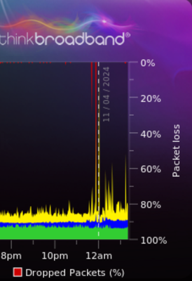

  • Today I had my repull done, new cable from the street has been installed but unfortunately it didn't help. Still dropouts. Unbelievable. Most likely it's an area issue
    11-04-2024 00:54:20noticeUS profile assignment change. US Chan ID: 6; Previous Profile: 12 13; New Profile: 11 13.;CM-MAC=**:**:**:**:**:**;CMTS-MAC=**:**:**:**:**:**;CM-QOS=1.1;CM-VER=3.1;
    11-04-2024 00:49:17noticeUS profile assignment change. US Chan ID: 6; Previous Profile: 11 13; New Profile: 12 13.;CM-MAC=**:**:**:**:**:**;CMTS-MAC=**:**:**:**:**:**;CM-QOS=1.1;CM-VER=3.1;
    10-04-2024 23:52:12criticalUnicast Maintenance Ranging attempted - No response - Retries exhausted;CM-MAC=**:**:**:**:**:**;CMTS-MAC=**:**:**:**:**:**;CM-QOS=1.1;CM-VER=3.1;
    10-04-2024 23:52:12critical16 consecutive T3 timeouts while trying to range on upstream channel 8;CM-MAC=**:**:**:**:**:**;CMTS-MAC=**:**:**:**:**:**;CM-QOS=1.1;CM-VER=3.1;
    10-04-2024 23:51:11criticalStarted Unicast Maintenance Ranging - No Response received - T3 time-out;CM-MAC=**:**:**:**:**:**;CMTS-MAC=**:**:**:**:**:**;CM-QOS=1.1;CM-VER=3.1;
    10-04-2024 23:51:10criticalStarted Unicast Maintenance Ranging - No Response received - T3 time-out;CM-MAC=**:**:**:**:**:**;CMTS-MAC=**:**:**:**:**:**;CM-QOS=1.1;CM-VER=3.1;
    10-04-2024 23:51:10noticeCM-STATUS message sent. Event Type Code: 4; Chan ID: 1 2 3 4 5 6 7 8 9 10 11 12 13 14 15 16 17 18 19 20 21 22 23 24 26 27 28 29 30 31 41; DSID: N/A; MAC Addr: N/A; OFDM/OFDMA Profile ID: N/A.;CM-MAC=**:**:**:**:**:**;CMTS-MAC=**:**:**:**:**:**;CM-QOS=1.1
    10-04-2024 23:51:10warningTCS Partial Service;CM-MAC=**:**:**:**:**:**;CMTS-MAC=**:**:**:**:**:**;CM-QOS=1.1;CM-VER=3.1;
    10-04-2024 23:51:04criticalStarted Unicast Maintenance Ranging - No Response received - T3 time-out;CM-MAC=**:**:**:**:**:**;CMTS-MAC=**:**:**:**:**:**;CM-QOS=1.1;CM-VER=3.1;
    10-04-2024 23:51:03noticeCM-STATUS message sent. Event Type Code: 22; Chan ID: 41; DSID: N/A; MAC Addr: N/A; OFDM/OFDMA Profile ID: N/A.;CM-MAC=**:**:**:**:**:**;CMTS-MAC=**:**:**:**:**:**;CM-QOS=1.1;CM-VER=3.1;
    10-04-2024 23:51:03noticeCM-STATUS message sent. Event Type Code: 24; Chan ID: 41; DSID: N/A; MAC Addr: N/A; OFDM/OFDMA Profile ID: 0 1 2 3.;CM-MAC=**:**:**:**:**:**;CMTS-MAC=**:**:**:**:**:**;CM-QOS=1.1;CM-VER=3.1;
    10-04-2024 23:50:41criticalNo Maintenance Broadcasts for Ranging opportunities received - T2 time-out;CM-MAC=**:**:**:**:**:**;CMTS-MAC=**:**:**:**:**:**;CM-QOS=1.1;CM-VER=3.1;
    10-04-2024 23:50:35criticalNo Ranging Response received - T3 time-out;CM-MAC=**:**:**:**:**:**;CMTS-MAC=**:**:**:**:**:**;CM-QOS=1.1;CM-VER=3.1;
    10-04-2024 23:50:34noticeCM-STATUS message sent. Event Type Code: 23; Chan ID: 41; DSID: N/A; MAC Addr: N/A; OFDM/OFDMA Profile ID: N/A.;CM-MAC=**:**:**:**:**:**;CMTS-MAC=**:**:**:**:**:**;CM-QOS=1.1;CM-VER=3.1;
    10-04-2024 23:50:33noticeCM-STATUS message sent. Event Type Code: 5; Chan ID: 1 2 3 4 5 6 7 8 9 10 11 12 13 14 15 16 17 18 19 20 21 22 23 24 26 27 28 29 30 31; DSID: N/A; MAC Addr: N/A; OFDM/OFDMA Profile ID: N/A.;CM-MAC=**:**:**:**:**:**;CMTS-MAC=**:**:**:**:**:**;CM-QOS=1.1;CM
    10-04-2024 23:50:15criticalNo Ranging Response received - T3 time-out;CM-MAC=**:**:**:**:**:**;CMTS-MAC=**:**:**:**:**:**;CM-QOS=1.1;CM-VER=3.1;
    10-04-2024 23:50:10warningMDD message timeout;CM-MAC=**:**:**:**:**:**;CMTS-MAC=**:**:**:**:**:**;CM-QOS=1.1;CM-VER=3.1;
    10-04-2024 23:50:08warningMDD message timeout;CM-MAC=**:**:**:**:**:**;CMTS-MAC=**:**:**:**:**:**;CM-QOS=1.1;CM-VER=3.1;
    10-04-2024 23:50:08criticalSYNC Timing Synchronization failure - Failed to acquire QAM/QPSK symbol timing;;CM-MAC=**:**:**:**:**:**;CMTS-MAC=**:**:**:**:**:**;CM-QOS=1.1;CM-VER=3.1;
    10-04-2024 23:50:06criticalSYNC Timing Synchronization failure - Failed to acquire QAM/QPSK symbol timing;;CM-MAC=**:**:**:**:**:**;CMTS-MAC=**:**:**:**:**:**;CM-QOS=1.1;CM-VER=3.1;
    10-04-2024 23:49:03noticeUS profile assignment change. US Chan ID: 6; Previous Profile: 12 13; New Profile: 11 13.;CM-MAC=**:**:**:**:**:**;CMTS-MAC=**:**:**:**:**:**;CM-QOS=1.1;CM-VER=3.1;
    10-04-2024 23:44:00noticeUS profile assignment change. US Chan ID: 6; Previous Profile: 11 13; New Profile: 12 13.;CM-MAC=**:**:**:**:**:**;CMTS-MAC=**:**:**:**:**:**;CM-QOS=1.1;CM-VER=3.1;
    10-04-2024 23:41:18criticalUnicast Maintenance Ranging attempted - No response - Retries exhausted;CM-MAC=**:**:**:**:**:**;CMTS-MAC=**:**:**:**:**:**;CM-QOS=1.1;CM-VER=3.1;
    10-04-2024 23:41:18critical16 consecutive T3 timeouts while trying to range on upstream channel 3;CM-MAC=**:**:**:**:**:**;CMTS-MAC=**:**:**:**:**:**;CM-QOS=1.1;CM-VER=3.1;
    10-04-2024 23:40:10criticalStarted Unicast Maintenance Ranging - No Response received - T3 time-out;CM-MAC=**:**:**:**:**:**;CMTS-MAC=**:**:**:**:**:**;CM-QOS=1.1;CM-VER=3.1;
    10-04-2024 23:39:49noticeCM-STATUS message sent. Event Type Code: 4; Chan ID: 1 2 3 4 5 6 7 8 9 10 11 12 13 14 15 16 17 18 19 20 21 22 23 24 41; DSID: N/A; MAC Addr: N/A; OFDM/OFDMA Profile ID: N/A.;CM-MAC=**:**:**:**:**:**;CMTS-MAC=**:**:**:**:**:**;CM-QOS=1.1;CM-VER=3.1;
    10-04-2024 23:39:48warningTCS Partial Service;CM-MAC=**:**:**:**:**:**;CMTS-MAC=**:**:**:**:**:**;CM-QOS=1.1;CM-VER=3.1;
    10-04-2024 23:39:43noticeCM-STATUS message sent. Event Type Code: 22; Chan ID: 41; DSID: N/A; MAC Addr: N/A; OFDM/OFDMA Profile ID: N/A.;CM-MAC=**:**:**:**:**:**;CMTS-MAC=**:**:**:**:**:**;CM-QOS=1.1;CM-VER=3.1;
    10-04-2024 23:39:43noticeCM-STATUS message sent. Event Type Code: 24; Chan ID: 41; DSID: N/A; MAC Addr: N/A; OFDM/OFDMA Profile ID: 0 1 2 3.;CM-MAC=**:**:**:**:**:**;CMTS-MAC=**:**:**:**:**:**;CM-QOS=1.1;CM-VER=3.1;
    10-04-2024 23:39:43noticeCM-STATUS message sent. Event Type Code: 5; Chan ID: 1 2 3 4 5 6 7 8 9 10 11 12 13 14 15 16 17 18 19 20 21 22 23 24 26 27 28 29 30 31; DSID: N/A; MAC Addr: N/A; OFDM/OFDMA Profile ID: N/A.;CM-MAC=**:**:**:**:**:**;CMTS-MAC=**:**:**:**:**:**;CM-QOS=1.1;CM
    10-04-2024 23:39:43noticeCM-STATUS message sent. Event Type Code: 23; Chan ID: 41; DSID: N/A; MAC Addr: N/A; OFDM/OFDMA Profile ID: N/A.;CM-MAC=**:**:**:**:**:**;CMTS-MAC=**:**:**:**:**:**;CM-QOS=1.1;CM-VER=3.1;
    10-04-2024 23:39:23criticalNo Ranging Response received - T3 time-out;CM-MAC=**:**:**:**:**:**;CMTS-MAC=**:**:**:**:**:**;CM-QOS=1.1;CM-VER=3.1;

    3.0 Upstream channels
    04960000049.35120QAM 641
    14310000048.85120QAM 642
    23660000048.85120QAM 643
    33010000048.55120QAM 644
    423600000485120QAM 645
    0ATDMA02100
    1ATDMA02200
    2ATDMA0260
    3ATDMA0270
    4ATDMA0290
    3.1 Upstream channels
    61145.02KQAM 256
    6OFDMA22074000000250
    ___________________________________________________________________________________________
    3.0 Downstream channels
    13310000001.541QAM 25625
    21390000001.740QAM 2561
    31470000001.740QAM 2562
    41550000001.440QAM 2563
    51630000001.440QAM 2564
    61710000001.140QAM 2565
    71790000000.940QAM 2566
    81870000000.540QAM 2567
    91950000000.640QAM 2568
    102030000000.440QAM 2569
    112110000000.140QAM 25610
    122190000000.240QAM 25611
    132270000000.540QAM 25612
    142350000000.340QAM 25613
    152430000000.540QAM 25614
    162510000000.540QAM 25615
    172590000000.440QAM 25616
    182670000000.141QAM 25617
    192750000000.341QAM 25618
    202830000000.741QAM 25619
    212910000000.941QAM 25620
    222990000001.241QAM 25621
    233070000001.441QAM 25622
    243150000001.441QAM 25623
    253230000001.642QAM 25624
    263390000001.641QAM 25626
    273470000001.741QAM 25627
    283550000001.642QAM 25628
    293630000001.542QAM 25629
    303710000001.241QAM 25630
    313790000000.741QAM 25631
    1Locked41130
    2Locked403451
    3Locked403442
    4Locked403367
    5Locked403460
    6Locked403361
    7Locked404343
    8Locked404559
    9Locked402951
    10Locked402950
    11Locked403265
    12Locked403443
    13Locked402743
    14Locked402639
    15Locked402936
    16Locked403138
    17Locked402838
    18Locked412031
    19Locked412334
    20Locked412139
    21Locked412247
    22Locked412531
    23Locked411723
    24Locked411526
    25Locked422323
    26Locked411630
    27Locked411730
    28Locked422029
    29Locked422225
    30Locked411548
    31Locked411732
    3.1 Downstream channels
    41944K1840QAM 40961108
    41Locked40-6.23201914253

    • Ayisha_B's avatar
      Ayisha_B
      Hi qwertyui
      I am sorry you are still having issues?
      Have you tried rebooting the hub since the work was carried out to see if this helps?
      • qwertyui's avatar
        qwertyui
        Yes. Can network team double check for any issues in the area? Maybe someone introducing noise in the line or something
