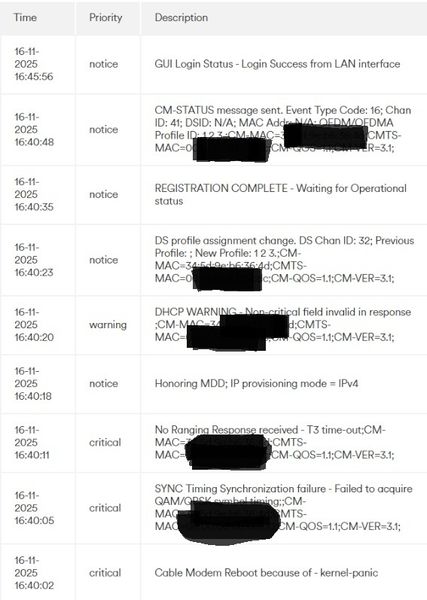

DOCSIS issue
My modem log shows repeated kernel-panic reboots, SYNC Timing Synchronization failures, and T3 timeouts, all indicating a clear problem with upstream/downstream signal quality on the line or at the node. The modem frequently loses its DOCSIS 3.1 lock and falls back to DOCSIS 3.0, which also explains the reduced speeds.
This is not a LAN issue. These are network-level signal faults.
I kindly request an on-site technician visit with full signal measurement ( SNR, downstream/upstream power, OFDM stability, outdoor connectors, and tap/not check).
Please escalate this issue, as it is persistent and severely impacting service reliability.

    Intel Atom CPU Kernel Panic Restarts are a fault of the Intel CPU in the VM Hub.
    The only fix is to request a replacement VM Hub.
    If you have DOCSIS signal level concerns, share the contents of the Upstream and Downstream
    status tabs for review.

      This is the 2nd hub I got within a year. I don't think is the issue.
        Look at the last entry in the log you posted.
        We can all see the kernel panic message.
        This is a defective Hub.

    Can you post a more complete log (as text)? The events just after a crash/reboot are somewhat meaningless.

      The log shows the exact same thing for the last 2 weeks without any changes. (I removed the MAC)
      17-11-2025 07:57:19 notice GUI Login Status - Login Success from LAN interface
      16-11-2025 17:17:56 notice GUI Login Status - Login Success from LAN interface
      16-11-2025 16:45:56 notice GUI Login Status - Login Success from LAN interface
      16-11-2025 16:40:48 notice CM-STATUS message sent. Event Type Code: 16; Chan ID: 41; DSID: N/A; MAC Addr: N/A; OFDM/OFDMA Profile ID: 1 2 3.;CM-MAC=xx:xx:xx:xx:xx:xx;CMTS-MAC=xx:xx:xx:xx:xx:xx;CM-QOS=1.1;CM-VER=3.1;
      16-11-2025 16:40:35 notice REGISTRATION COMPLETE - Waiting for Operational status
      16-11-2025 16:40:23 notice DS profile assignment change. DS Chan ID: 32; Previous Profile: ; New Profile: 1 2 3.;CM-MAC=xx:xx:xx:xx:xx:xx;CMTS-MAC=xx:xx:xx:xx:xx:xx;CM-QOS=1.1;CM-VER=3.1;
      16-11-2025 16:40:20 warning DHCP WARNING - Non-critical field invalid in response ;CM-MAC=xx:xx:xx:xx:xx:xx;CMTS-MAC=xx:xx:xx:xx:xx:xx;CM-QOS=1.1;CM-VER=3.1;
      16-11-2025 16:40:18 notice Honoring MDD; IP provisioning mode = IPv4
      16-11-2025 16:40:11 critical No Ranging Response received - T3 time-out;CM-MAC=xx:xx:xx:xx:xx:xx;CMTS-MAC=xx:xx:xx:xx:xx:xx;CM-QOS=1.1;CM-VER=3.1;
      16-11-2025 16:40:05 critical SYNC Timing Synchronization failure - Failed to acquire QAM/QPSK symbol timing;;CM-MAC=xx:xx:xx:xx:xx:xx;CMTS-MAC=xx:xx:xx:xx:xx:xx;CM-QOS=1.1;CM-VER=3.1;
      16-11-2025 16:40:02 critical Cable Modem Reboot because of - kernel-panic
      16-11-2025 08:27:09 critical No Ranging Response received - T3 time-out;CM-MAC=xx:xx:xx:xx:xx:xx;CMTS-MAC=xx:xx:xx:xx:xx:xx;CM-QOS=1.1;CM-VER=3.1;
      16-11-2025 08:27:03 critical SYNC Timing Synchronization failure - Failed to acquire QAM/QPSK symbol timing;;CM-MAC=xx:xx:xx:xx:xx:xx;CMTS-MAC=xx:xx:xx:xx:xx:xx;CM-QOS=1.1;CM-VER=3.1;
      16-11-2025 08:27:02 critical Cable Modem Reboot because of - kernel-panic
      05-11-2025 19:58:05 critical No Ranging Response received - T3 time-out;CM-MAC=xx:xx:xx:xx:xx:xx;CMTS-MAC=xx:xx:xx:xx:xx:xx;CM-QOS=1.1;CM-VER=3.1;
      05-11-2025 19:57:58 critical Cable Modem Reboot because of - HW or Power-On Reset
      05-11-2025 19:57:58 critical SYNC Timing Synchronization failure - Failed to acquire QAM/QPSK symbol timing;;CM-MAC=xx:xx:xx:xx:xx:xx;CMTS-MAC=xx:xx:xx:xx:xx:xx;CM-QOS=1.1;CM-VER=3.1;
      05-11-2025 19:54:17 critical No Ranging Response received - T3 time-out;CM-MAC=xx:xx:xx:xx:xx:xx;CMTS-MAC=xx:xx:xx:xx:xx:xx;CM-QOS=1.1;CM-VER=3.1;
      05-11-2025 19:54:11 critical SYNC Timing Synchronization failure - Failed to acquire QAM/QPSK symbol timing;;CM-MAC=xx:xx:xx:xx:xx:xx;CMTS-MAC=xx:xx:xx:xx:xx:xx;CM-QOS=1.1;CM-VER=3.1;
      05-11-2025 19:54:10 critical Cable Modem Reboot because of - kernel-panic
      29-10-2025 11:35:02 critical SYNC Timing Synchronization failure - Failed to acquire QAM/QPSK symbol timing;;CM-MAC=xx:xx:xx:xx:xx:xx;CMTS-MAC=xx:xx:xx:xx:xx:xx;CM-QOS=1.1;CM-VER=3.1;
      29-10-2025 11:34:55 critical SYNC Timing Synchronization failure - Loss of Sync;CM-MAC=xx:xx:xx:xx:xx:xx;CMTS-MAC=xx:xx:xx:xx:xx:xx;CM-QOS=1.1;CM-VER=3.1;
      29-10-2025 11:33:57 critical No Ranging Response received - T3 time-out;CM-MAC=xx:xx:xx:xx:xx:xx;CMTS-MAC=xx:xx:xx:xx:xx:xx;CM-QOS=1.1;CM-VER=3.1;
      29-10-2025 11:28:14 critical SYNC Timing Synchronization failure - Loss of Sync;CM-MAC=xx:xx:xx:xx:xx:xx;CMTS-MAC=xx:xx:xx:xx:xx:xx;CM-QOS=1.1;CM-VER=3.1;
      29-10-2025 11:24:08 critical SYNC Timing Synchronization failure - Failed to acquire QAM/QPSK symbol timing;;CM-MAC=xx:xx:xx:xx:xx:xx;CMTS-MAC=xx:xx:xx:xx:xx:xx;CM-QOS=1.1;CM-VER=3.1;
      28-10-2025 19:59:42 critical No Ranging Response received - T3 time-out;CM-MAC=xx:xx:xx:xx:xx:xx;CMTS-MAC=xx:xx:xx:xx:xx:xx;CM-QOS=1.1;CM-VER=3.1;
      28-10-2025 19:59:37 critical Cable Modem Reboot because of - kernel-panic
      28-10-2025 19:59:37 critical SYNC Timing Synchronization failure - Failed to acquire QAM/QPSK symbol timing;;CM-MAC=xx:xx:xx:xx:xx:xx;CMTS-MAC=xx:xx:xx:xx:xx:xx;CM-QOS=1.1;CM-VER=3.1;
      23-10-2025 16:55:07 critical Unicast Maintenance Ranging attempted - No response - Retries exhausted;CM-MAC=xx:xx:xx:xx:xx:xx;CMTS-MAC=xx:xx:xx:xx:xx:xx;CM-QOS=1.1;CM-VER=3.1;
      23-10-2025 16:55:07 critical 16 consecutive T3 timeouts while trying to range on upstream channel 8;CM-MAC=xx:xx:xx:xx:xx:xx;CMTS-MAC=xx:xx:xx:xx:xx:xx;CM-QOS=1.1;CM-VER=3.1;
      23-10-2025 16:55:01 critical Started Unicast Maintenance Ranging - No Response received - T3 time-out;CM-MAC=xx:xx:xx:xx:xx:xx;CMTS-MAC=xx:xx:xx:xx:xx:xx;CM-QOS=1.1;CM-VER=3.1;
      23-10-2025 16:10:21 critical No Ranging Response received - T3 time-out;CM-MAC=xx:xx:xx:xx:xx:xx;CMTS-MAC=xx:xx:xx:xx:xx:xx;CM-QOS=1.1;CM-VER=3.1;
      23-10-2025 16:10:17 critical SYNC Timing Synchronization failure - Failed to acquire QAM/QPSK symbol timing;;CM-MAC=xx:xx:xx:xx:xx:xx;CMTS-MAC=xx:xx:xx:xx:xx:xx;CM-QOS=1.1;CM-VER=3.1;
      23-10-2025 16:10:16 critical Cable Modem Reboot because of - Reboot UI
      23-10-2025 15:19:44 critical No Ranging Response received - T3 time-out;CM-MAC=xx:xx:xx:xx:xx:xx;CMTS-MAC=xx:xx:xx:xx:xx:xx;CM-QOS=1.1;CM-VER=3.1;
      • gitty's avatar
        gitty
        All the sync fails are logged just after the halt, so we cannot conclude anything about the signal quality from that. What triggers the halt...?
        Do you see more of those event 16 that flags profiles 1, 2 and 3?
