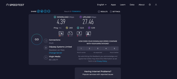

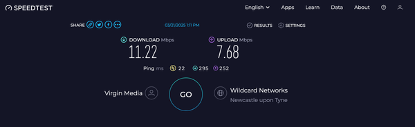

Deco X55 + 5x + M350 = 11MB speed
Hello,
I have Deco X55 (3 points) + 5x and M350. QOS disabled.
The result is this:
How to resolve this?
Thank you
