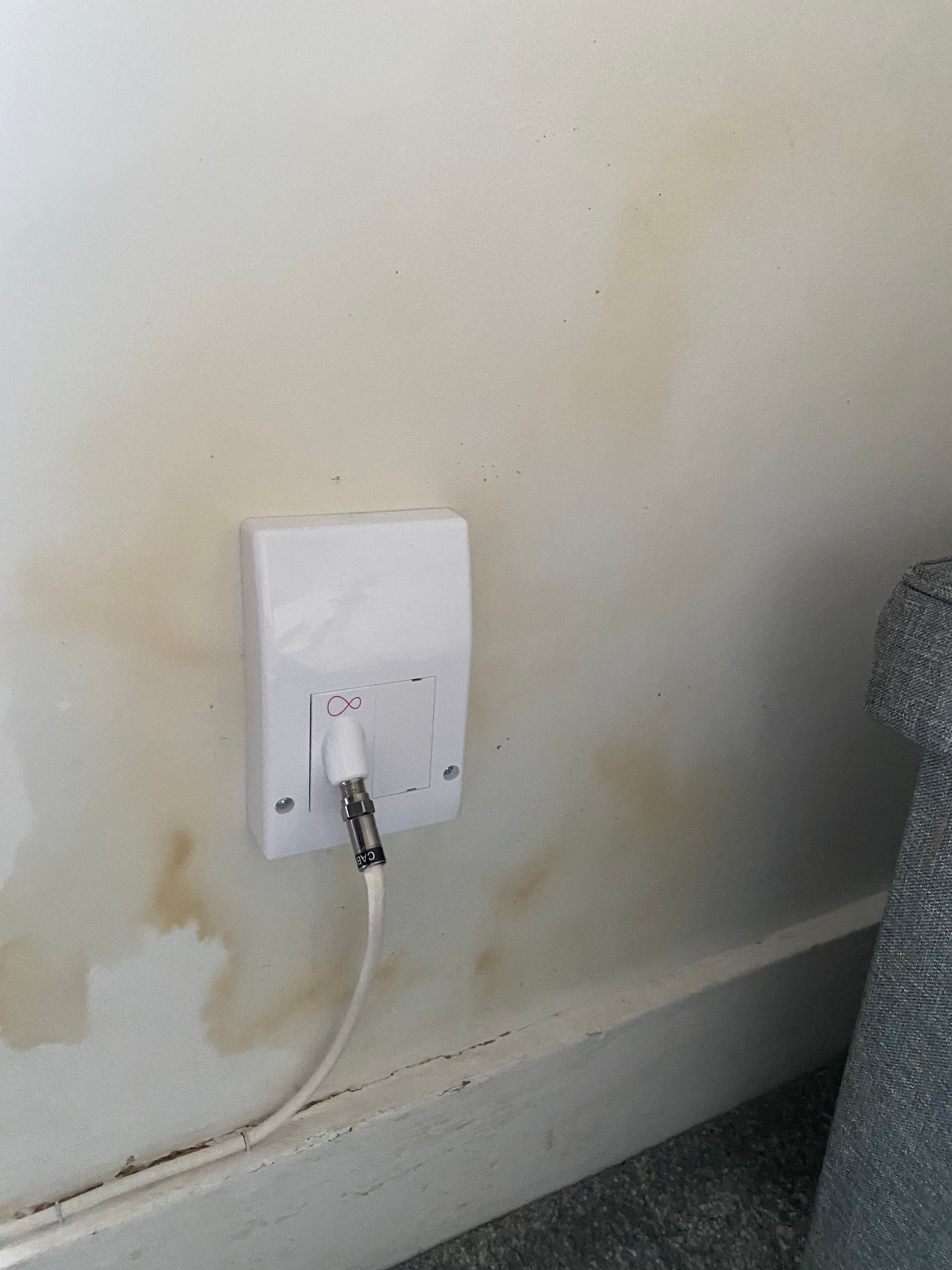

Damp mark near VM socket - weather damage?
Hello Virgin Media community,
I hope you’re all doing well. I’m reaching out here because I’ve encountered an issue since the installation of my Wi-Fi cable. With the recent cold weather and rainy days, a damp mark has appeared around the Virgin Media socket on my wall.
I’m a bit concerned about potential damage, and I’m seeking advice from the community or any Virgin Media representatives on how to address this. Has anyone else faced a similar situation? Any guidance on the appropriate steps to take would be greatly appreciated.
Looking forward to your insights!

    Post up photos of the internal and external side of the VM socket.

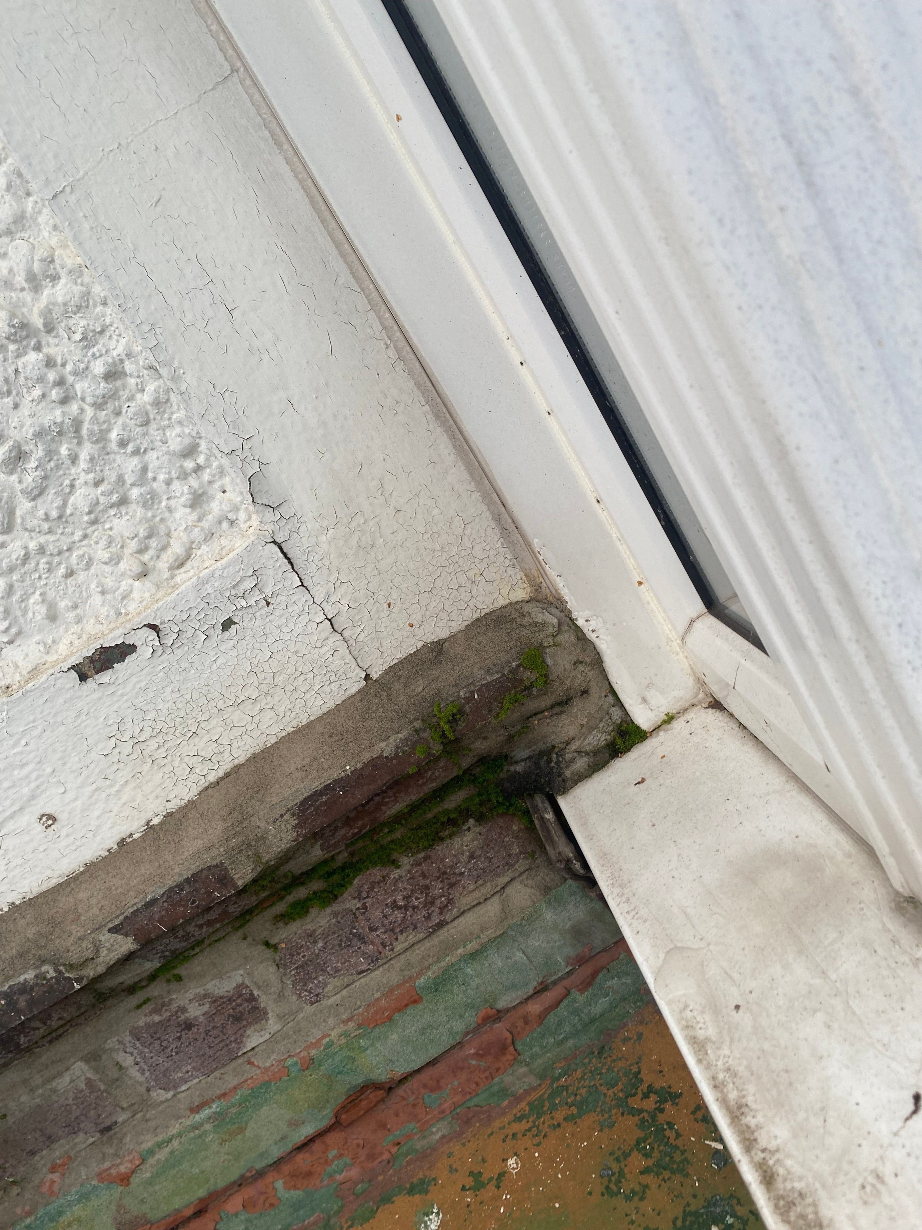

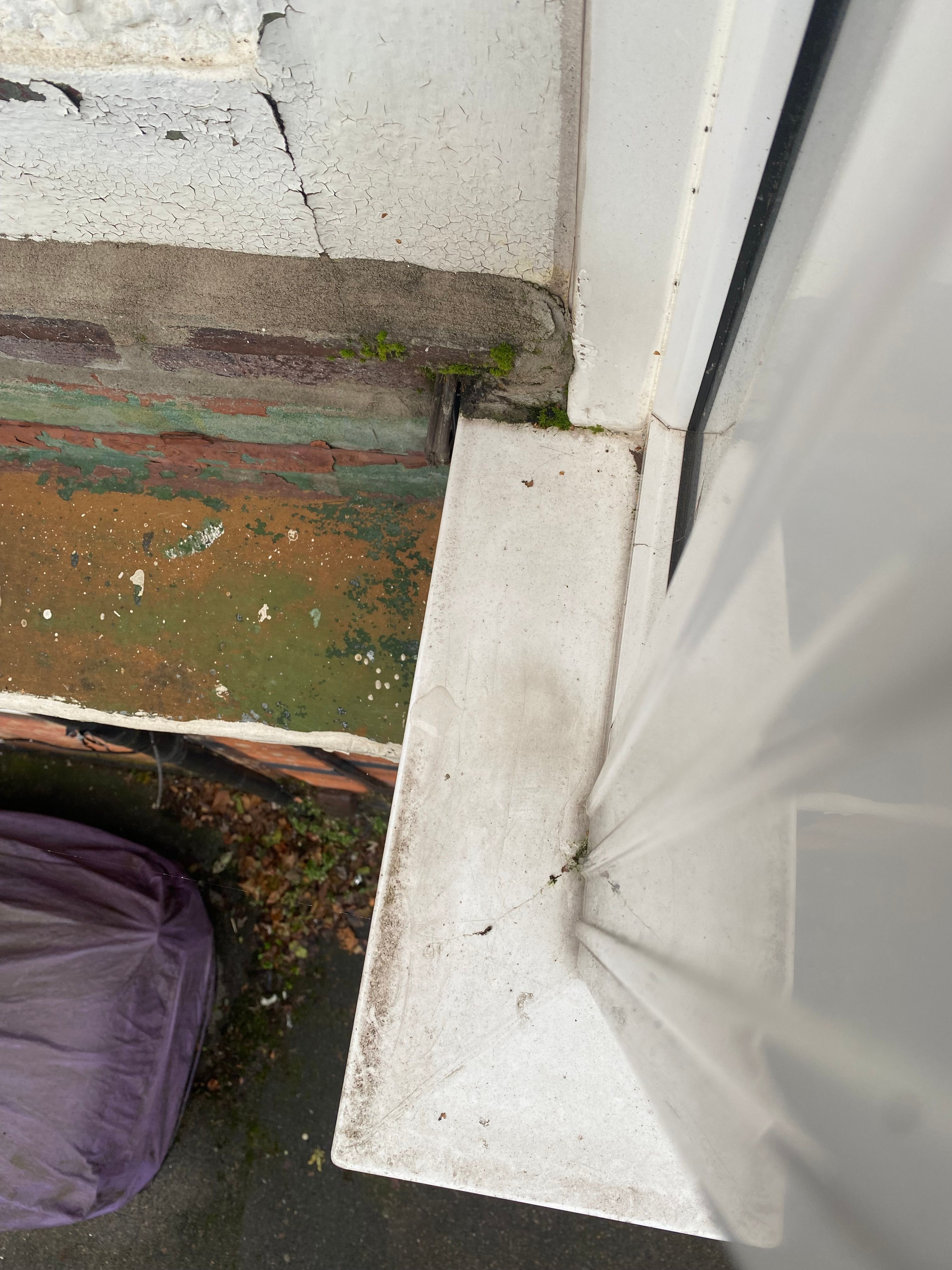

        Not clear to me on your external photos whether the hole where the VM cable enters the property has been properly sealed (with "silicone sealant") to prevent water ingress.  Do you have a close up photo of that point?
  • goslow's avatar
    goslow
    The internal photo certainly shows a damp problem but the outside pictures suggest there is possibly more going on than just the VM cable.
    The outside wall areas look soaked and saturated with water with moss growing on the mortar and there are more than a few gaps and cracks in the sealing materials on the outside.
    Nothing to say the VM cable might be contributing in some way to the problem but there may be other causes too.
    Is there guttering in the area above the outside photos? If there is, is that clear, free flowing and free from any leaks?
    (Fixed a similar problem at my own home in the summer where the water leak coming inside actually turned out to be due to failed silicone sealant around the uPVC window frame)
  • Roger_Gooner's avatar
    Roger_Gooner
    I suggest you get a dehumidifier to remove excess moisture in that room, otherwise you can get mould. I've had a number of dehumidifiers for years and you'd be surprised how quickly the water tank can sometimes fill up.
