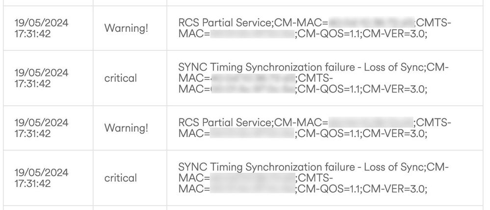

Hi.  I frequently experiencing daily broadband outages which last about a minute or two.  This happens at least twice a day and it's getting really frustrating .
I have been through all the diagnostic steps and tried the usual rebooting of my Virgin Superhub etc. I have also seen other reports on here of people suffering the same issues as mine but none seem to show how to resolve the issue.
See the attached log of the last outage.  This is what I am seeing posted often on the forums.

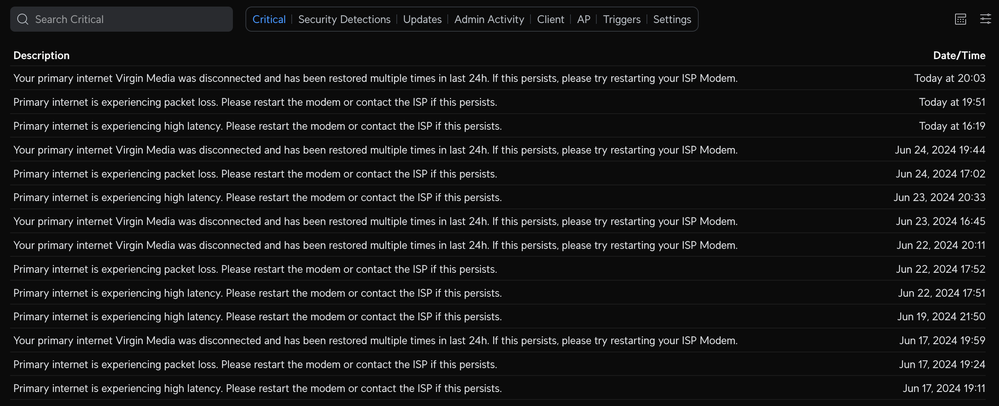

  • It appears my daily occurrence of outages has returned.  It always appears to be in the evenings where I am experiencing loss of service as seen from my Unifi logs below.   Do I require an engineer visit to resolve this?

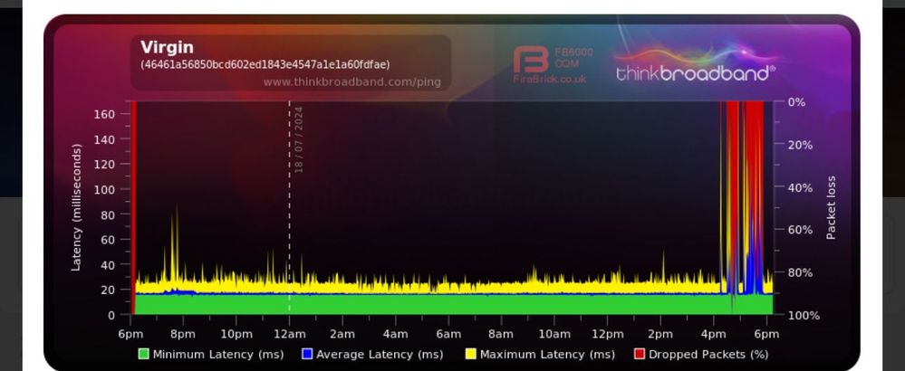

        Here is my BQM graph from today:
        It's the same experience I am experiencing from 4pm to 8pm where I'm constantly getting periods of disconnect that occur daily.

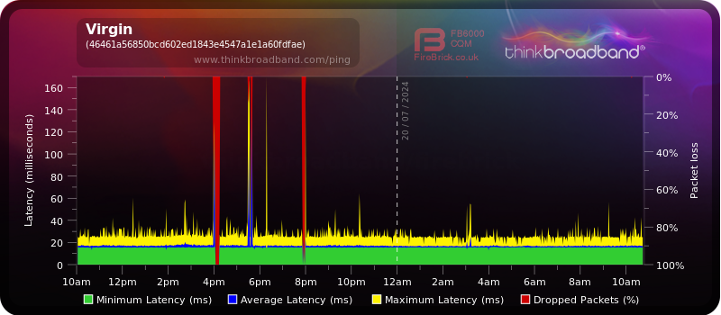

  • My daily outages are back.  This has been on-going for the past 4 days so it;s clearly not just a one off.  See below of my broadband quality monitor for the past 24 hours.

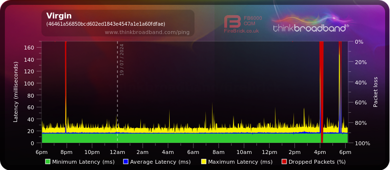

  • BQM showing the outages yesterday from 4pm to 8pm.

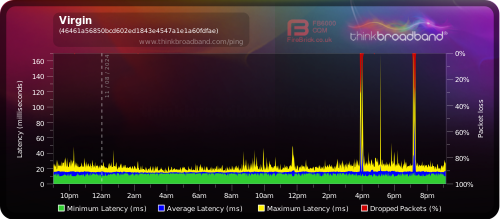

        After 2 modem swapouts by engineers, the latter being swapped for a superhub 5 the outages from 4-8pm have started again.  I don't believe this was ever a modem issue but possibly to do with infrastructure.
        BQM for today below:
        It seems the issues I have been experiencing ever since joining Virgin 6 months ago cannot be resolved.  What are the next steps that I can take as I'm currently paying for an intermittent service without any forms of reimbursement so far.
