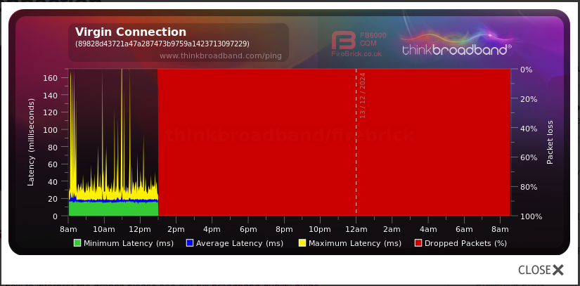

I've always had a somewhat dubious connection provided by you but in the past couple of months the frequency and intensity of ping jitter has gone through the roof, making it borderline unusable for a lot of important things I use it for in "peak" hours. This is getting to the stage where we've already inquired about alternative providers, and if this can't be solved then I'll be moving forward with it ASAP. Have months of graphs on this, can provide more on request
Live Graph:
https://www.thinkbroadband.com/broadband/monitoring/quality/share/a22811a5279790752e5fe8422773317d9b791390
Snapshot of Yesterday:
https://www.thinkbroadband.com/broadband/monitoring/quality/share/9130433dc92158300e4a161ff0aabd7b9458f9ed-11-12-2024
"Peak" hour experience (Sunday):

  • Apologies, this is the link for Sunday, doubled up on the live graph by mistake:
    https://www.thinkbroadband.com/broadband/monitoring/quality/share/4dcc26187066a8d2fe22f5586bfce5b8184e0edd-08-12-2024
    I just looked at the live BQM.
    What happened between 1am and 8:30am this morning, why is the BQM all red ?

      Genuinely couldn't tell you, the connection is still active (though still up/down in stability), though in some cases it reaches a point where it fully disconnects during a spike and comes back a little while later, unsure if that would cause it to fully sever the BQM packets from being sent. There's a few more instances of it happening in the past week.
      For reference the connection went from *relatively* stable around 12-1pm as shown, and at 1-1:15pm yesterday it went haywire for the remainder of the day, stopping only around 2am. Symptoms are extremely unstable rocketing MS usually between 5-2000 for 1-2 seconds, then back down, repeating every 5 seconds or so. No registered packet loss from the software I'm live monitoring it on my end with though, purely latency.
    The BQM being all red is very important, that needs to be understood.
    It has a couple of explanations ...
    1) Either your VM Hub was turned off during that period.
    2) Or the BQM does not point to the Public IP of your VM Hub connection,
        it points to a device that has been off-line from 1am.
  • jpeg1's avatar
    jpeg1
    Yes the BQM is now looking at a different WAN IP.  But that's not relevant to the ongoing problem which on first look appears to be due to local oversubscription.
    To eliminate your own connection we need to see the Hub data.
