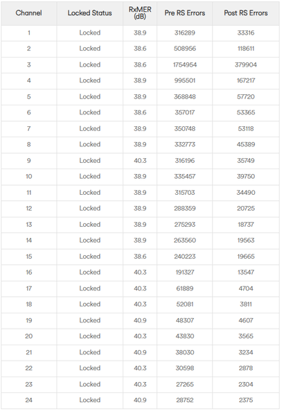

        The below are the updated after turning off for 10mins (about 44h before these screenshots). Everything did reset to 0, but started having pre and post errors straight away and kept going up.
        Everything is just under 48h

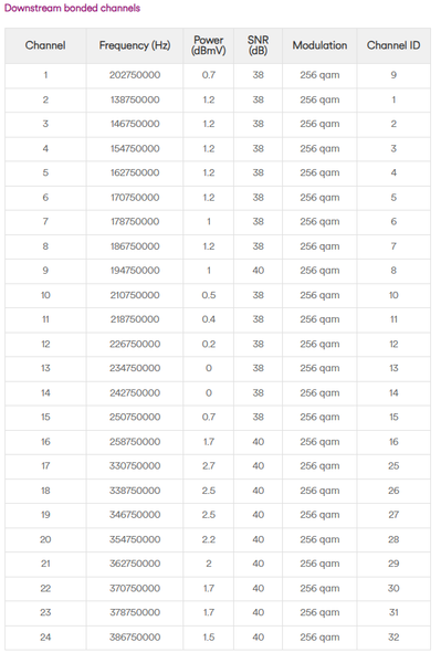

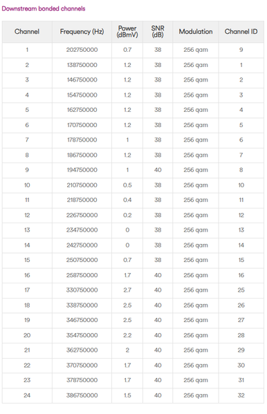

    Downstream bonded channels
    ChannelFrequency (Hz)Power (dBmV)SNR (dB)ModulationChannel ID
    12027500000.738256 qam9
    21387500001.238256 qam1
    31467500001.238256 qam2
    41547500001.238256 qam3
    51627500001.238256 qam4
    61707500001.238256 qam5
    7178750000138256 qam6
    81867500001.238256 qam7
    9194750000140256 qam8
    102107500000.538256 qam10
    112187500000.438256 qam11
    122267500000.238256 qam12
    13234750000038256 qam13
    14242750000038256 qam14
    152507500000.738256 qam15
    162587500001.740256 qam16
    173307500002.740256 qam25
    183387500002.540256 qam26
    193467500002.540256 qam27
    203547500002.240256 qam28
    21362750000240256 qam29
    223707500001.740256 qam30
    233787500001.740256 qam31
    243867500001.540256 qam32

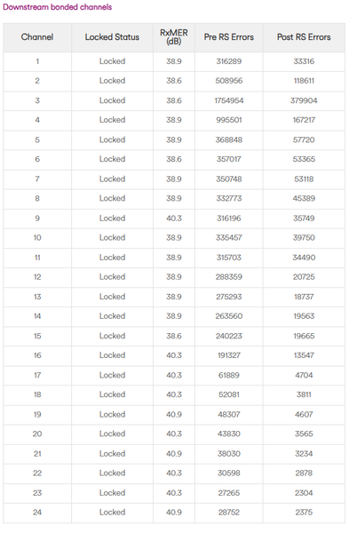

    ChannelLocked StatusRxMER (dB)Pre RS ErrorsPost RS Errors
    1Locked38.931628933316
    2Locked38.6508956118611
    3Locked38.61754954379904
    4Locked38.9995501167217
    5Locked38.936884857720
    6Locked38.635701753365
    7Locked38.935074853118
    8Locked38.933277345389
    9Locked40.331619635749
    10Locked38.933545739750
    11Locked38.931570334490
    12Locked38.928835920725
    13Locked38.927529318737
    14Locked38.926356019563
    15Locked38.624022319665
    16Locked40.319132713547
    17Locked40.3618894704
    18Locked40.3520813811
    19Locked40.9483074607
    20Locked40.3438303565
    21Locked40.9380303234
    22Locked40.3305982878
    23Locked40.3272652304
    24Locked40.9287522375

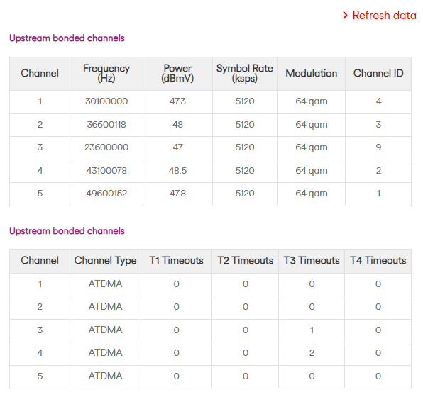

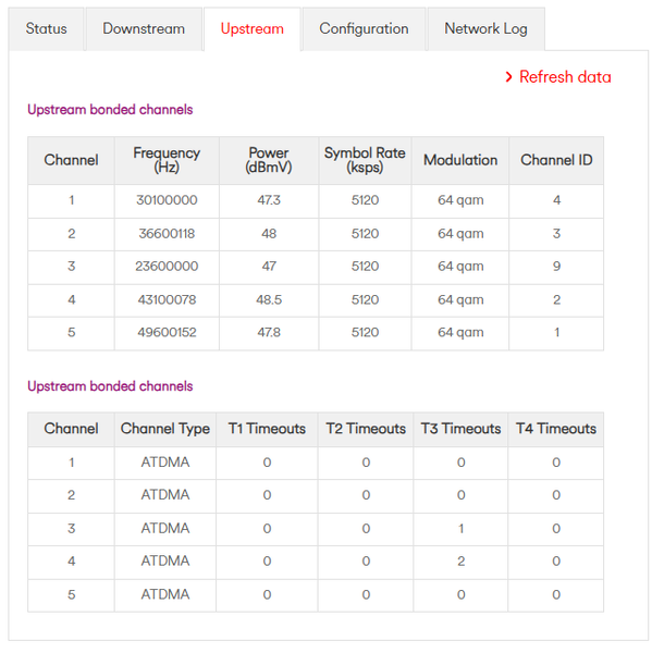

    Upstream bonded channels
    ChannelFrequency (Hz)Power (dBmV)Symbol Rate (ksps)ModulationChannel ID
    13010000047.3512064 qam4
    23660011848512064 qam3
    32360000047512064 qam9
    44310007848.5512064 qam2
    54960015247.8512064 qam1
    ChannelChannel TypeT1 TimeoutsT2 TimeoutsT3 TimeoutsT4 Timeouts
    1ATDMA0000
    2ATDMA0000
    3ATDMA0010
    4ATDMA0020
    5ATDMA0000

    There is a great deal of noise still appearing on all the downstream channels. The most likely cause is a cable fault either internally, on the external cable, or one of your neighbours' connections.
