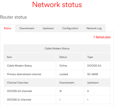

      Thanks, I'm on the router page now but can't seem to find an option to export the Downstream, Upstream. The Network Logs don't load. I've attached a snip of the Status.

    Looks like the router may have been forced to restart due to errors earlier, there was also 16 consecutive T3 errors yesterday (making it a T4 time out) - the Sync errors are also indicative of a problem.
    This all needs investigation by a Virgin Engineer (if you wait a few days, the forum team will reach out). Could also contact the social media team on X/Facebook - this may be quicker.
