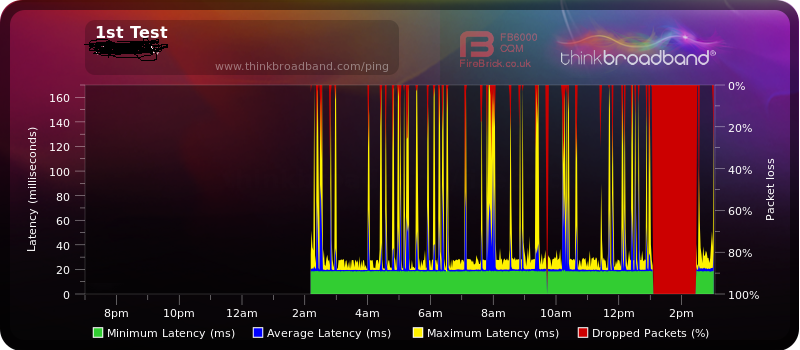

So my connection has been very bad for the past month. First of all i thought it was on issues on black ops 6 on PC as i was lagging out of every other game but I'm also losing the connection on my phone, tv and other devices regardless of wired or WIFI connection. It seems as if the whole router stops the connections for a few seconds to a minute. So far i have reset my router several times with the reset button, ive reset through the admin portal all settings. I've left the router off for hours but still no fix. i came across others with issues and they posted Broadband quality monitor graphs so i did the same and its a lot worse than i thought. I have check over all cabled and they seem fine. when im connected im getting great dload and upload speeds. Take a look at the graph. i have told virgin who are sending a new hub 5 out as im currently on hub 3 and i also upgraded to 1 gig so im  hoping it would fix it but im unsure as others have similar issues on hub 5. Ignore the red period in the graph as that was the point i tried my router in modem mode only but it didnt fix any issues.

    You need to post your power levels and network log from the Hub for comment.  Also try checking with Area faults on 0800 561 0061 or if you have a VM landline 150 as small local faults are not listed on the VM status page.
    I would have held off upgrading, as I'm pretty certain this will not fix your issue.
