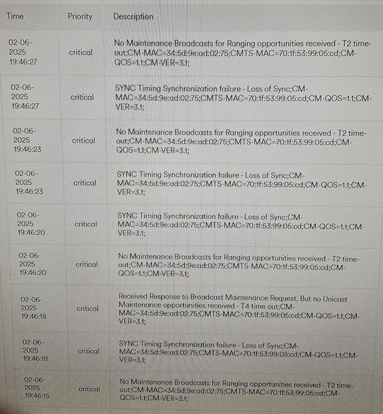

This is the log just after it went off if it makes any sense to anyone??

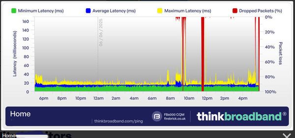

    Setup a BQM to monitor your circuit www.thinkbroadband.com/ping

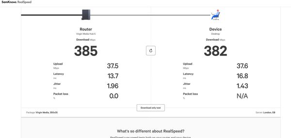

    Run a wired speed test on www.samknows.com/realspeed and post the results.
    Once done we can comment.

    Network Log
    [Mod edit: MAC details removed]
    • legacy1's avatar
      legacy1
      upstream power to high lots of timeout and downstream power too low

      This is todays, its gone off several times..
      can someone from virgin please advise, or book and engineer to visit??
      Its going down 6-10 times a day every day..
      thanks.

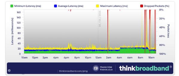

  • Its gone off several times today..
    my son is home trying to finish his college report and it keeps cutting him off...
    can someone from Virgin advise, or book an engineer... thanks..

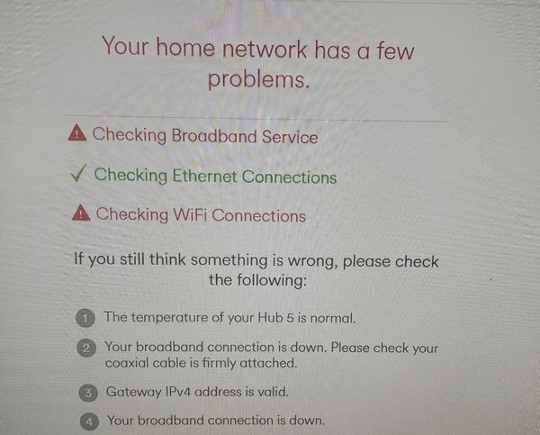

      It just went off again and I have been on the system checker on the app and now its saying I need to book an engineer, so have done that...
    Unless there is a 10dB wideband attenuator that can be removed from the coax to the Hub 5,
    phone in and request and engineer corrects the signal levels.

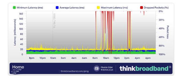

  • Not speed issues, when its working the speed is great, its reliability issues..
    This was yesterdays graph....
