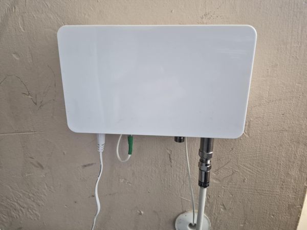

    Full fibre meaning XGS-PON and a Hub 5x usually TV streaming only over internet. The give away for this is the Hub 5x has a fibre optic cable directly connected to it and a metal 10 Gbps network port.
    Or full fibre meaning RFoG where now the ONT is internal to the home and there is coax from it to a VM Hub 3/4/5 and a 360 box would supported ?
    This is RFoG with an internal ONT that is in the pictured white box.
    This replaced the external OMNI box ONT installation that we have from late 2017, but functionally and electrically they are identical.
    The plus is when it comes time the convert to XGS-PON the fibre cable is already inside the home.   Also the ONT is not subject to winter weather.
