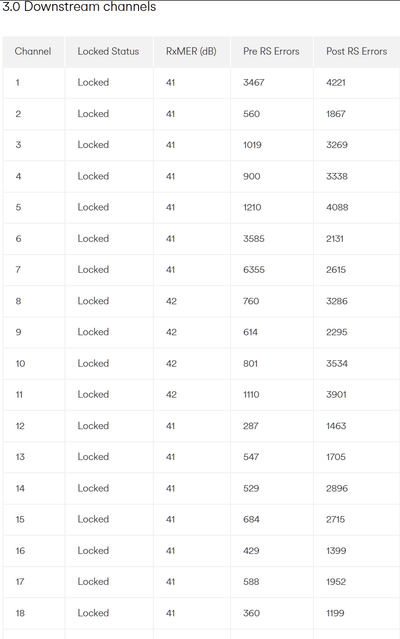

      Hello,
      Sorry for the late reply, didn't get notified by email like I thought I would. This is everything in my log, my connection did drop out a bit around 7pm today, which is at the very bottom of the log:

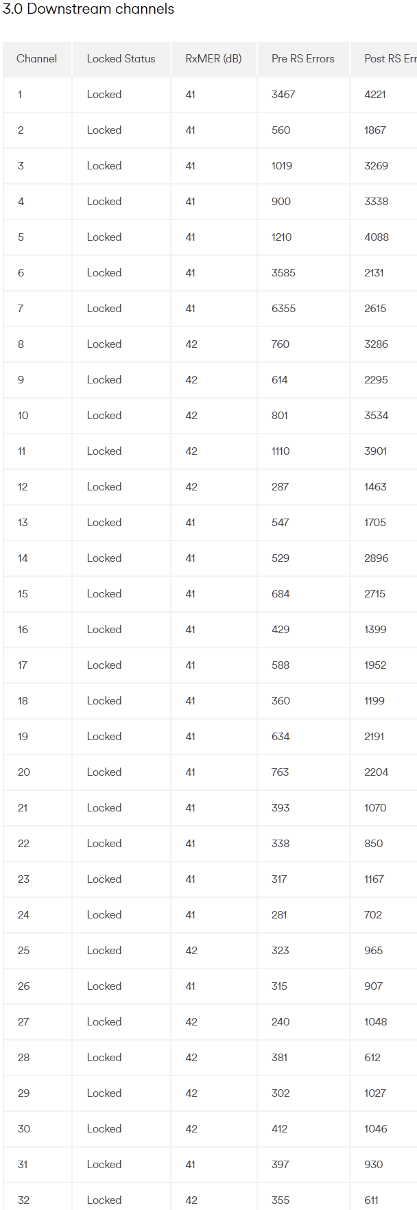

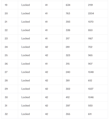

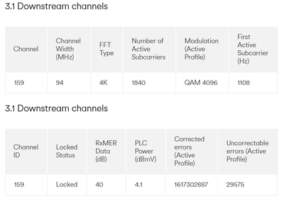

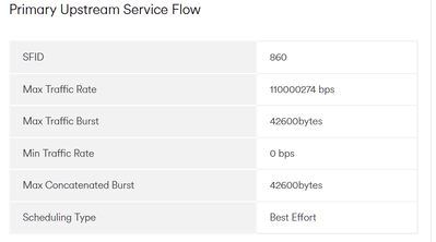

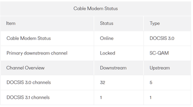

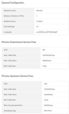

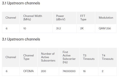

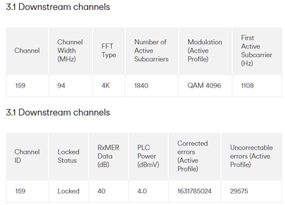

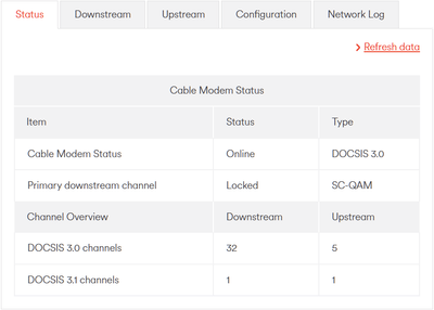

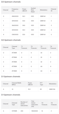

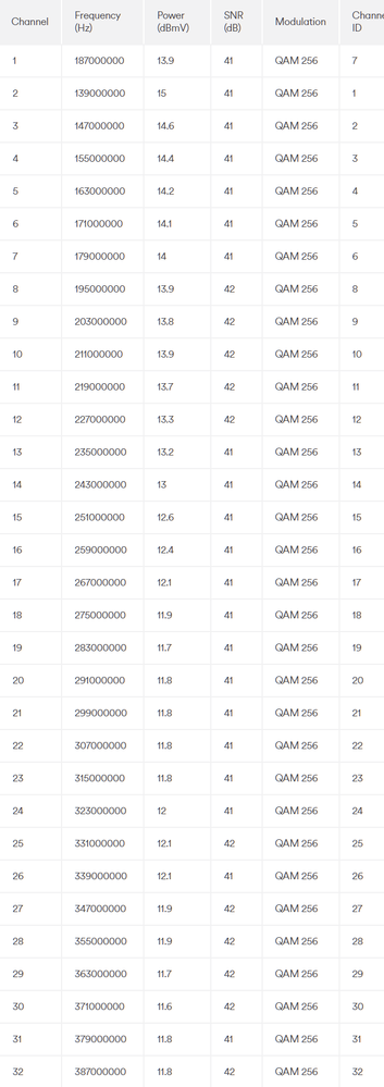

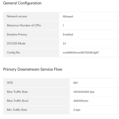

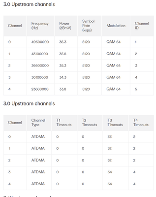

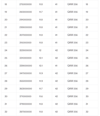

      Here is the status info:
      Downstream
      Upstream
      Config
      Thanks for the response, any further help is greatly appreciated

      Hello, thanks for the reply. I posted a reply just now but it seems to have... disappeared? I will post it again. I had no connection drops yesterday evening, but I did experience one at 7pm today, which is shown at the bottom of the network log
      Status
      Downstream
      Upstream
      Config
      Log

      • jbrennand's avatar
        jbrennand
        Difficult to see as you posted screen shots rather than text - but, your down power levels are all too high and ill be the cause of your issues.  A tech visit will be needed to get then in range (-6 to +10 dBmV)
        A VM person will respond here soon.
