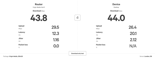

    Speed test the VM  service to the VM Hub using the link below :
    Once the test begins click on: Run full test to include: Latency, Jitter, Packet loss & Upload speed
    Post a screen shot of the full test so we can see what is occurring.

    Good to see the Realspeed test.  We can now see the service problem to the VM Hub.
    On M250 we would expect to see at least 250Mb/s at the Hub & we do not we see only 43.8Mb/s perhaps we can figure out why that is the case..

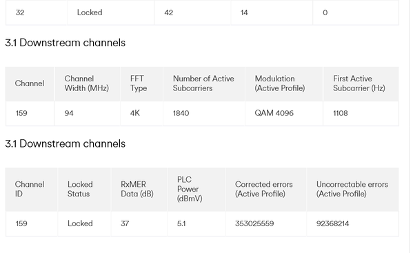

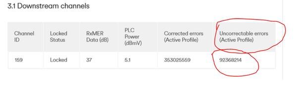

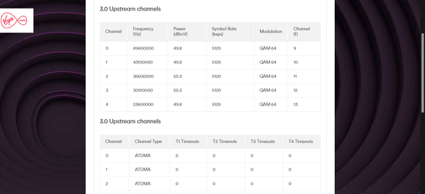

    If you can copy & paste the text of the Downstream tab and the Upstream tab so we can review the signal levels.
    There is an error problem on the 3.1 Downstream channel.
    Seeing the 3.0 Downstream channels look better it looks like a VM service fault.
