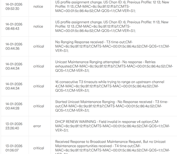

My connections constantly poor, the modems always switching doing US profile assignment changes and when this happens, I lose connection.
T4 timeouts are common.
T3 timeouts are sometimes in the thousands.

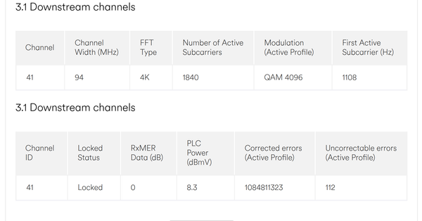

3.1 Downstream channel corrected errors are now in the BILLIONS and a fair few uncorrected errors.

    Corrected errors impose no/negligible load in the modem.  The FEC is in-line and is a function of the data stream.

  • I do have trust issues with the VM engineers. Every one has a different opinion on what should be right, Saturdays thought it was fine to bump me up a tap and throw the Power (dBmV) up beyond 10, being at 10 triggered the visit, he left after doing that and fitting a 3db attenuator. Problems persisted the same as before with the internet grinding to a halt and the modem logging a US profile assignment change at the same time.
    As nothing changed a senior tech was booked, he arrived, not sure, call it a hunch, after he told me he had only been with VM for 6 months that he wasn't a senior tech and didn't really know what to do about the issue, he told me the power levels were too high (really!) and moved me to the bottom tap, then he said he didn't think RG11 was suitable being around 50m from the cabinet and thought RG6 would be better. To me with some networking background would suggest it's better at keeping the noise out, anyway, he was meant to call back after speaking to his supervisor, I've chased this with the forum rep to see what is being done next, the outcome of today, internets taking longer to load pages, if I pull the modem and hotspot things speed up, if I go to router mode and plug in an RJ45 direct, the internet's slow loading pages again.
    in 75 minutes the routers logged 54380637 corrected errors on the downstream 3.1 channel, this has been on ongoing issue, and I can only imagine the modem is running flat out correcting 54 million errors in a little over an hour.
    A new error after being dropped down to the lowest tap.
    RNG-RSP CCAP Commanded Power in Excess of 6 dB Below the Value Corresponding to the Top of the DRW;CM-MAC=x;CMTS-MAC=x;CM-QOS=1.1;CM-VER=3.1;

      "RNG-RSP CCAP Commanded Power in Excess of 6 dB Below the Value" is a modem error indicating the HUB5 is operating outside its expected Dynamic Range Window, suggesting a possible signal issue or problem with the coaxial cable or splitters. This means the modem's transmission power is significantly lower than what the CCAP (Converged Cable Access Platform) expects to provide a reliable service.
      RNG-RSP: This refers to "Ranging Response," a process where the cable modem communicates with the CCAP to establish a stable connection and transmit data.
      CCAP Commanded Power: This is the power level the CCAP has instructed the modem to use for upstream transmission.
      Excess of 6 dB Below the Value Corresponding to the Top of the DRW: This indicates the modem is transmitting with a power level more than 6 dB lower than what's necessary to stay within the designated Dynamic Range Window. The Dynamic Range Window is a specific power level range needed for stable communication.

        6 dB below the top isn't an actual violation. The window is 12 dB. If a channel is 6 dB below the top, it means it is half way through the window. If possible, the system wants to have all channels in the top half, so the modem tells the CMTS, if it happens, so it may adjust the top (if possible).
        If there are no events logged after the technician was done fiddling with it, it was just caused by a sudden change in levels (the window needed a new top).

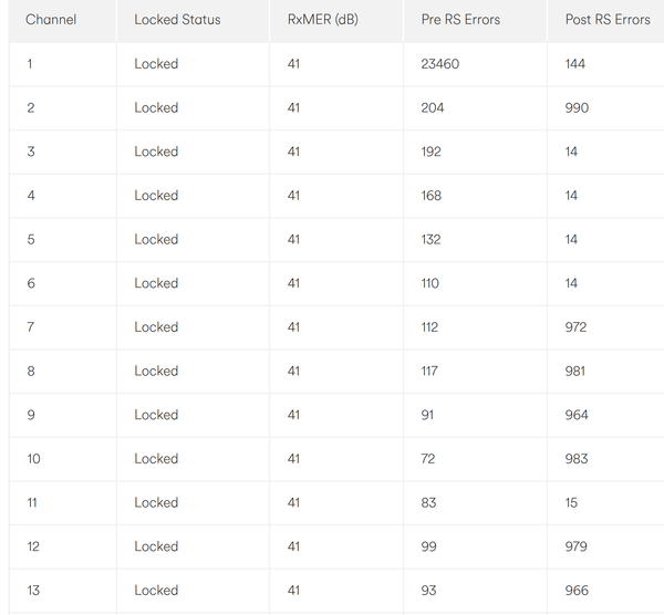

      Can you post your levels and event log? For all the curious minds :)
      You are not the first to get lost in the OFDM corrected errors. Forget it. It's not relevant in your troubleshooting. :)

        3.0 Upstream channels
        Channel    Frequency (Hz)    Power (dBmV)    Symbol Rate (ksps)    Modulation    Channel ID
        0    49600000    50    5120    QAM 64    1
        1    43100000    50.5    5120    QAM 64    2
        2    36600000    50.8    5120    QAM 64    3
        3    30100000    51    5120    QAM 64    4
        4    23600000    51.5    5120    QAM 64    5
        Channel    Channel Type    T1 Timeouts    T2 Timeouts    T3 Timeouts    T4 Timeouts
        0    ATDMA    0    0    1    0
        1    ATDMA    0    0    0    0
        2    ATDMA    0    0    0    0
        3    ATDMA    0    0    0    0
        4    ATDMA    0    0    0    0
        3.1 Upstream channels
        Channel    Channel Width (MHz)    Power (dBmV)    FFT Type    Modulation
        6    10.4    45.5    2K    QAM 256
        Channel    Channel Type    Number of Active Subcarriers    First Active Subcarrier (Hz)    T3 Timeouts    T4 Timeouts
        6    OFDMA    208    74000000    0    0
  • Back to the usual case of no resolution, yet again I had a tech sent out with a minimal explanation of the issue, or more to the point zero information regarding this being an ongoing issue where the issue has been proven time and time again to be nothing to do with the cable running from the cabinet to my house, nothing to do with the cabling around my house as it's all been replaced before, nothing to do with the router (that this time was replaced as it was running slow and hot, well what else will it do when it's logging a billion or more corrected errors, the router is on its knees trying to cope)
