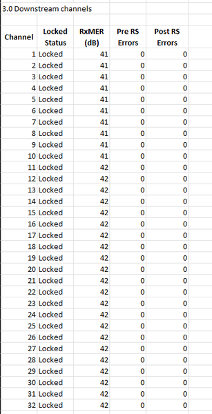

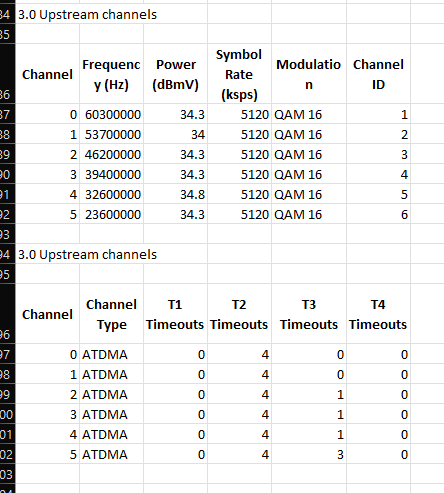

I rely on having good upload speeds, I have attached the connection details from my router along with a speedtest conducted at the same time. This is really really frustrating, I never had these problems on BT.

  • Upstream power and modulation look low to me. Check for local faults on 0800 561 0061.

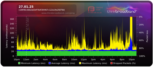

    also setup a BQM it be interesting to see how that looks

  • Looks like you are in an area with no provision for DOCSIS 3.1 upstream, which is probably the reason for six 3.0 upstream channels.
    Mine as an example:
    3.0 Upstream channels
    0 49600000 45 5120 QAM 64 1
    1 43100000 44.8 5120 QAM 64 2
    2 36600000 44.3 5120 QAM 64 3
    3 30100000 43.3 5120 QAM 64 4
    4 23600000 43.3 5120 QAM 64 5
    0 ATDMA 0 0 0 0
    1 ATDMA 0 0 0 0
    2 ATDMA 0 0 0 0
    3 ATDMA 0 0 0 0
    4 ATDMA 0 0 0 0
    3.1 Upstream channels
    6 10 39.2 2K QAM 256
    6 OFDMA 200 74000000 134 5
    Six 3.0 channels should still be sufficient, assuming correct modulation, which yours is not.

  • BQM for the first few hours. Showing a bit of packet loss consistently. Latency at its highest seems to be about 80ms. This is during a period when the upstream ahs been behaving much better than it has been over the previous 24 hours.
    • legacy1's avatar
      legacy1
      its not the worst BQM we have seen but its still bad so needs fixing

        Todays BQM:
  • jpeg1's avatar
    jpeg1
    The BQM and your upstream data together suggest oversubscription - too many connections in your local area. If that proves correct they shouldn't have connected yet another user.
    You certainly need a technician visit, and show them the BQM. But if it's a network problem there will be no quick fix.
  • @jedexodus,  As said above, your Upstream levels are bad.
    VM need to sort the HFC / RFoG alignment.  Chances are that others in your area have the same issue.

    The thing to watch, in conjunction with the BQM, is that the upstream modulation should be, and stay on, 64QAM.
