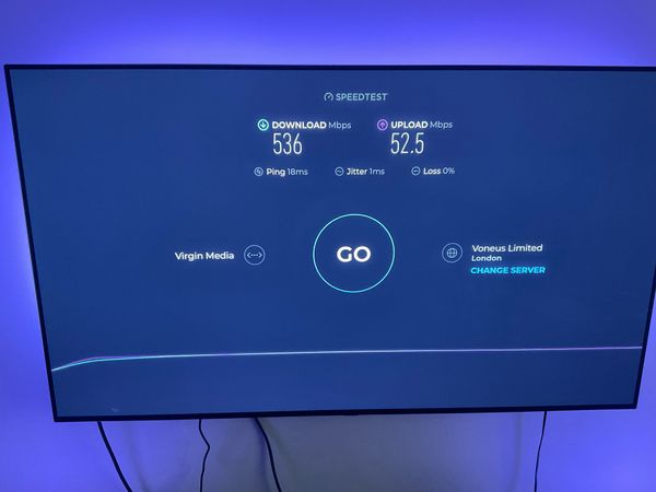

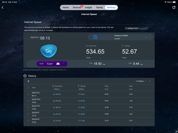

      So currently, vm hub in modem mode, hard wired to asus. In asus settings, speed test shows over 500mb:
      From the ASUs, the Apple TV, Denon, ps5 etc all hard wired. They get 500mb:

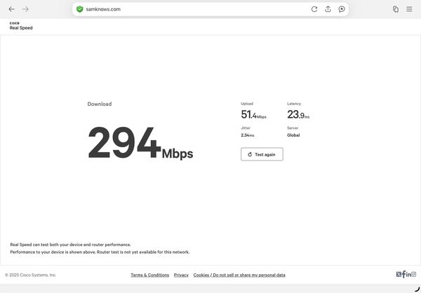

      But WiFi connected devices are only getting 294mb
  • I have the same router and it's excellent. However it's important to disable adaptive QoS.
    If that fails also try disabling beamforming in Wireless /Advanced.
    • Affy9's avatar
      Affy9
      You sir, are a gentleman and scholar. This seems to have worked. Thank you so much.
