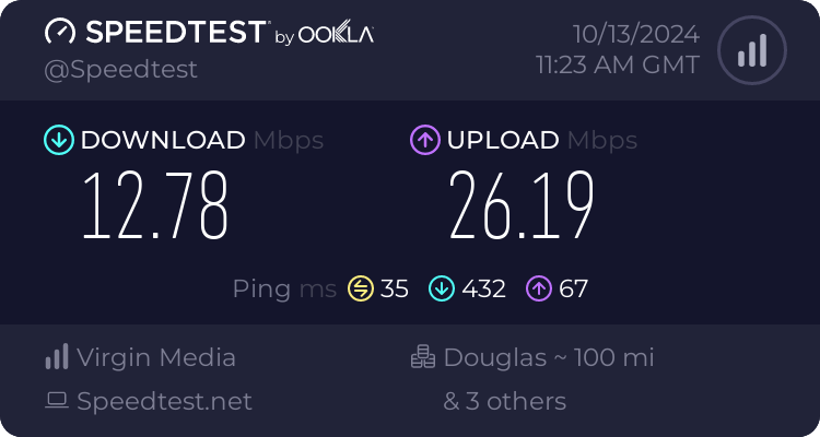

    Here's a typical speed test that I've been experiencing recently, before switching to modem mode and installing the mesh system. Many times though the speed has been down into single figures and sometimes losing internet connection entirely despite still being connected to the WiFi with a strong signal.

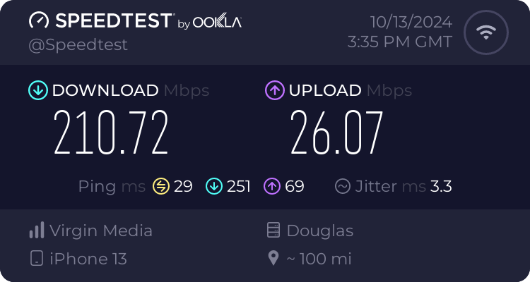

  • And for completeness here is another speed test from the same phone, later in the day using the Tp-Link mesh.
    This is NOT using the Hub WiFi.
