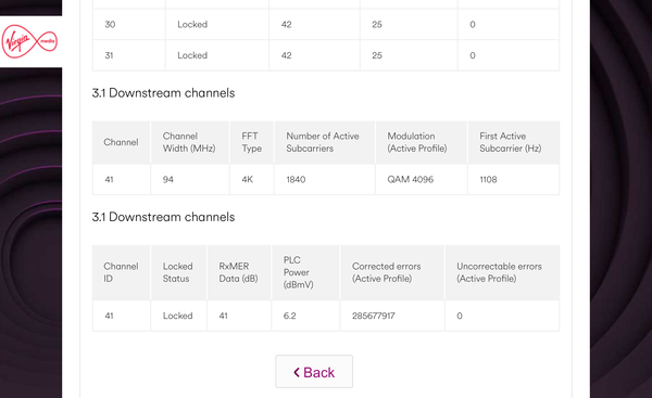

Hi,
At very random times I lose service for a few minutes. This doesnt happen everyday or every week, it happens very randomly. Looking at the hub 5 logs I see this message "16 consecutive T3 timeouts while trying to range on upstream channel 8".
Looking closer it seems to be related to the docsis 3.1 upstream channel. For some unknown reason a large number of timeouts occur which takes the internet down for a few minutes. Ive been on the phone with CS who dont really have an idea of what I was talking about. I would like to know what causes these consecutive T3 timeouts and if anyone else with a hub 5 has similar issues?
Reboots and factory resets dont work. Ive already had a few hub 5's and new cables, the issue still occurs.
Neighbours that I talk to have hub 3's and they dont get these interruptions when I get mine and Im assuming this is because they're using docsis 3.0 channels?
Any advise would be appreciated.
Thanks

    3.0 Downstream channels
    1Locked401870
    2Locked401100
    3Locked401010
    4Locked391100
    5Locked391030
    6Locked39980
    7Locked391240
    8Locked391180
    9Locked391340
    10Locked391261
    11Locked391380
    12Locked382030
    13Locked381880
    14Locked382030
    15Locked381810
    16Locked391864
    17Locked391710
    18Locked391570
    19Locked391610
    20Locked391690
    21Locked401850
    22Locked401870
    23Locked402220
    24Locked402791
    25Locked412160
    26Locked412822
    27Locked413440
    28Locked422980
    29Locked423300
    30Locked423590
    31Locked423540
    3.1 Downstream channels
    41944K1840QAM 40961108
    41Locked415.985038151511
  • 3.0 Upstream channels
    04960000045.55120QAM 641
    14310000045.35120QAM 642
    23660000045.35120QAM 643
    330100000455120QAM 644
    42360000044.85120QAM 645
    0ATDMA0000
    1ATDMA0020
    2ATDMA0000
    3ATDMA0000
    4ATDMA0000
    3.1 Upstream channels
    610.440.52KQAM 256
    6OFDMA20874000000360

    The profile changes on the upstream are the clue to what's going on.  The higher the two numbers, the poorer the upstream signal.  The IUC value 13 is the fallback value (likely to be 16QAM) and is the value used for initialisation.  The value 11 or 12 (going down to 9) is the higher modulation in data traffic.  I don't know the VM configured settings but I surmise:
    12 = 32QAM;   11 = 64QAM;  10 = 128QAM;  9 = 256QAM.
    The CMTS performs the signal quality check periodically at the upstream line card, looking at your stats that seems to be a 5 minute period.  The IUC change affects everyone in your segment who is on the same upstream channels (which might not be everyone).
    Everything we can se in the logs, networks can see on the CMTS event logs and, I suspect, will receive alarms if the events occurrence exceeds a threshold (that I don't know).
    So yes, the network log shows the upstream struggling at various times.

    16-01-2025 11:02:26     warning                DHCP WARNING - Non-critical field invalid in response ;CM-MAC=-;CMTS-MAC=-;CM-QOS=1.1;CM-VER=3.1;
    16-01-2025 11:02:24     notice    Honoring MDD; IP provisioning mode = IPv4
    16-01-2025 11:02:21     critical   No Ranging Response received - T3 time-out;CM-MAC=-;CMTS-MAC=-;CM-QOS=1.1;CM-VER=3.1;
    16-01-2025 11:02:15     critical   SYNC Timing Synchronization failure - Failed to acquire QAM/QPSK symbol timing;;CM-MAC=-;CMTS-MAC=**:**:**:**:**:**;CM-QOS=1.1;CM-VER=3.1;
    16-01-2025 11:02:14     critical   Cable Modem Reboot because of - Erouter Mode Change
    16-01-2025 10:28:15     critical   No Ranging Response received - T3 time-out;CM-MAC=-;CMTS-MAC=-;CM-QOS=1.1;CM-VER=3.1;
    16-01-2025 10:28:10     critical   SYNC Timing Synchronization failure - Failed to acquire QAM/QPSK symbol timing;;CM-MAC=-;CMTS-MAC=**:**:**:**:**:**;CM-QOS=1.1;CM-VER=3.1;
    16-01-2025 10:28:09     critical   Cable Modem Reboot because of - pin-reset
    • Sephiroth's avatar
      Sephiroth
      That looks like the Docsis 3.1 downstream giving problems.  There may have been a largeish # of uncorrectables, but I couldn't distinguish the number from the rubbish formatting that those fools have enforced.
