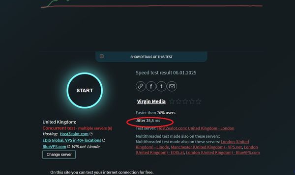

I had several issues on my service during January and February 2025. Also 2023 and 2024 was full of high jitter and drops. Those issues reduced in autumn of 2024 when VM engineer changed to SH5 at my request as SH4 and SH3 has the problematic Puma  05, 06 and O7 chipsets causing packet loss and vulnerabilities and Intel firmware never fully fixed those issues.
SH 4 had many times blue lights and I also had to restart it twice a lot of times as the first restart didn't do anything.
Nobody should have this kind of service and pay 47/month for 135 Mbit service which is delivered in this way. I use SH and SH5 now in modem mode as they barley can handle that task.
This is my log for January and February
Overall SH 5 runs much warmer in January and February 2025 compared to December 2024. VM Router sits on planks and not a carpet.
January 4 several drops morning and evening
January 8 bad service most of the day, several drops in the evening restarted the router
January  10  white light on the VM router and pour quality  with high Jitter meassured on London servers. The light should be green as is in Modem mode
January 18 and 19 on 19 had to restart Router Twice because even with green light after first restart was no internet on none of the Devices.
January 21 high ping and high Jitter  several drops on cabled devices and NOT WiFi
January  28   drops of internet had to restart Router twice again, first restart didn't give internet despite having a GREEN F LIGHT

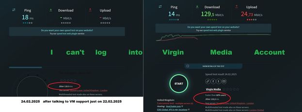

17 of February Blue Light no net is not even weekend is just a  Monday. Restarted twice the router. First restart didn't do s**t. Wasted 20 minutes.
22 February awfull service all day. High jitter  nearly 20ms  Called VM in the evening apparently I need an VM engineer, agreed for 25 February
After the call internet is excellent 1.4 ms jitter from nearly 20 ms.  Is just shows again that the problem is not on my side but, Server Routing and Prioritization, oversubscribed area, overheating and overwhelmed exchange box  etc.

    I had Virgin Media at 3 addresses on 5 different machines and in all cases was congestion issues, SH issues(puma chipsets) , with or without packet loss. But always jitter was high.
    After last VM engineer visit my jitter was perfect 0.7-1.3 ms
    Last weekend I struggled again with buffering and jitter raised to 4.5ms. Ethernet Cable  Connection only
    Like in all weekends my service works as like VM is working in the area. I compete with my VM neighbors over an oversubscribed and congested network.
    Buffering on 1080 p or 1440P video on 250Mbit service!!!!!
    How come only when VM engineers are around or after I talk with VM tech over the phone jitter normalize!??!?!?!?1!?!?!
    A normal jitter over ethernet cable is under 1ms,   not 4-5ms or 26ms.
    The issue lies on VM side, I know VM too long unfortunately.
