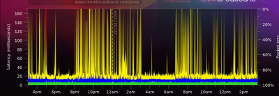

At very random times I lose service for a few minutes. This doesnt happen everyday or every week, it happens very randomly. Looking at the hub 5 logs I see this message "16 consecutive T3 timeouts while trying to range on upstream channel 8".
Looking closer it seems to be related to the docsis 3.1 upstream channel. For some unknown reason a large number of timeouts occur which takes the internet down for a few minutes. Ive been on the phone with CS who dont really have an idea of what I was talking about. I would like to know what causes these consecutive T3 timeouts and if anyone else with a hub 5 has similar issues?
Reboots and factory resets dont work. Ive already had a few hub 5's and new cables, the issue still occurs.
Neighbours that I talk to have hub 3's and they dont get these interruptions when I get mine and Im assuming this is because they're using docsis 3.0 channels?
Any advise would be appreciated.
Thanks
