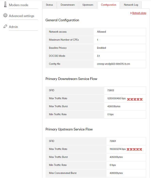

      You can double check what speed you've been assigned by opening a browser window and logging  into the hub settings  http://192.168.0.1/   and going to the Advanced Settings > Configuration tab
      See what it shows under Max Traffic Rate for both the Primary Downstream Service Flow and Primary Upstream Service Flow.(as per screenshot below)

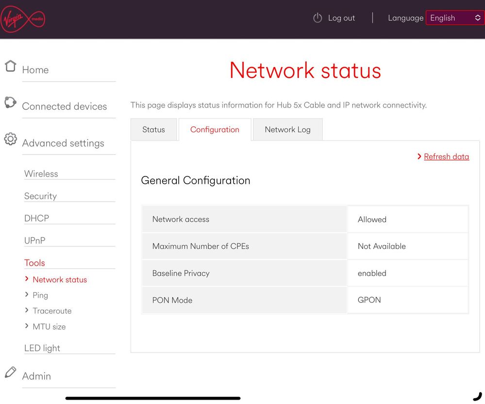

      • epwg1's avatar
        epwg1
        This option doesn’t seem to be on the 5x hub
