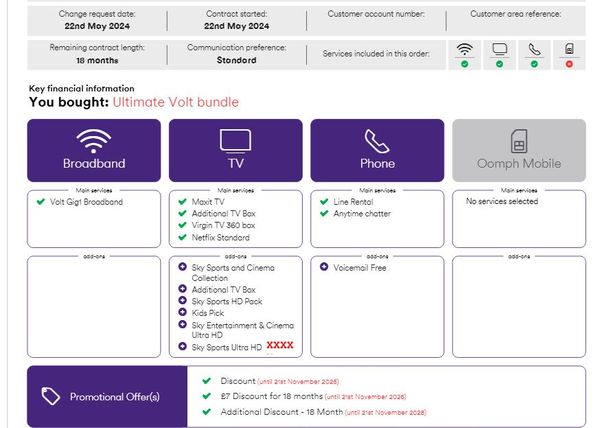

    Hi andyk8870​
    Log into My Virgin Media and check your latest contract - you should have an add on named Sky Sports Ultra HD showing (see screenshot below) if that's missing then you need it adding back on.
