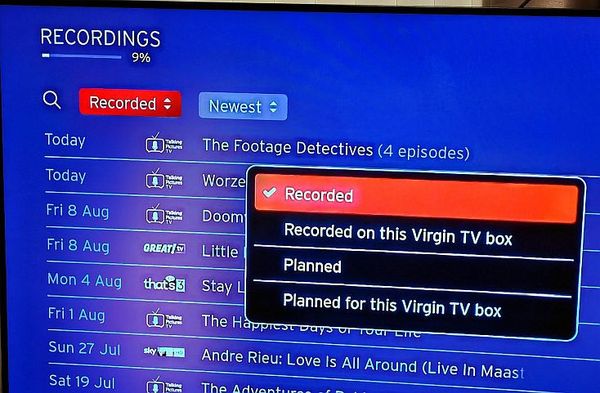

  • Hi Jim,
    Go to Recordings , click on Recorded (View all)
    On the screen that opens highlight Recorded (to the right of the search icon) and press OK.
    That opens a sub menu (shown below) where there are 4 options you can select from:-
     'Recorded', Recorded on this Virgin TV box' , 'Planned', and 'Planned for this Virgin TV box'

    Hi Jim,

      I can assure you we do have two full blown 360 boxes. Until last night most recordings could be played on either box, we only got the ‘box in lounge not switched on’ occasionally. Thanks to the post above I can now check which recordings are on which box.
      last night the lounge box appeared to be working correctly but on the bedroom box some recordings could not be viewed, also it was not possible to delete recordings from this box.
      This morning the problem seems to have resolved itself so I will now check on which recordings are on each box.
      EDIT. Using the info from above I can confirm that both boxes have different lists of recordings stored, there may be the odd duplicate but not many that I can see at first glance.
