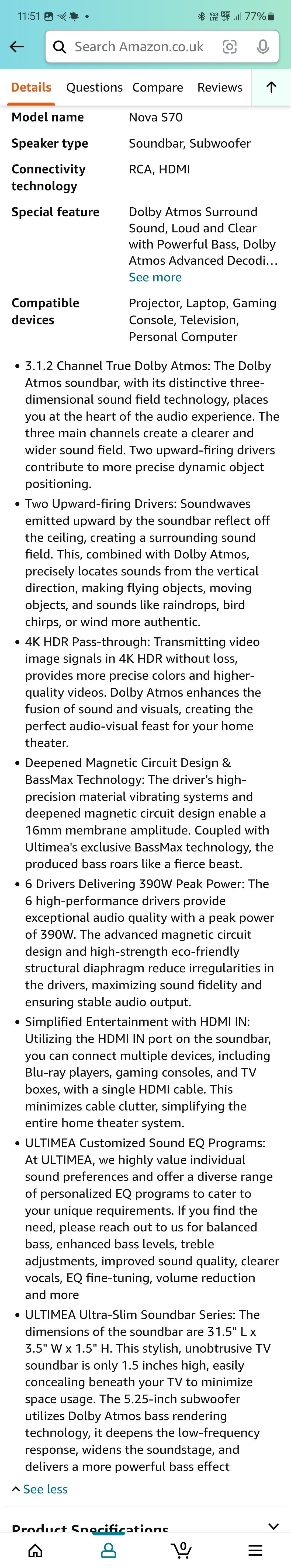

    Does the sound bar have the option to send either PCM/Stereo/Normal vs Dolby Surround/Bitstream to the TV ?
    • Jeff15's avatar
      Jeff15
       Really don't know, it's this. Hopefully this pic is clear.
