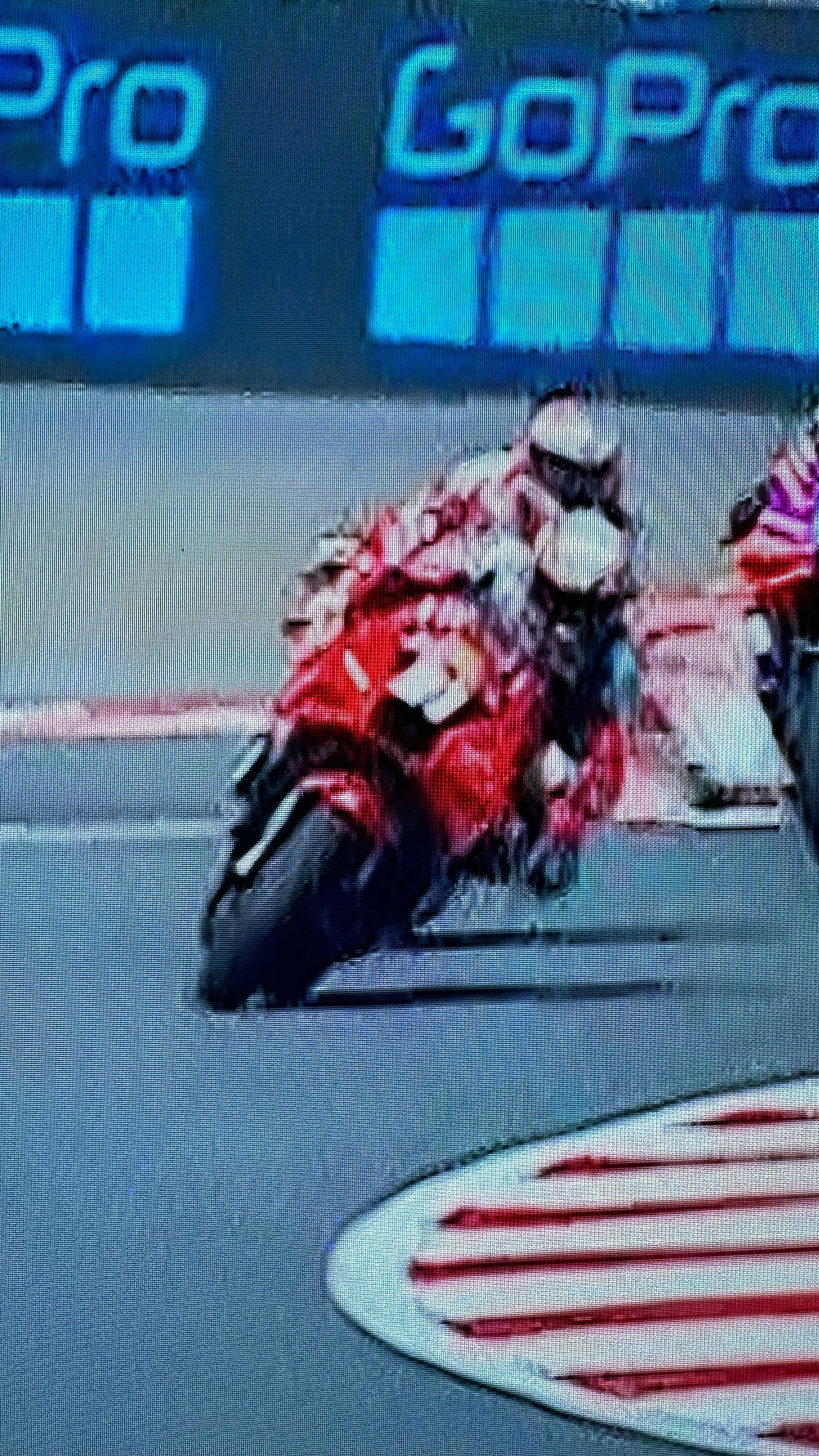

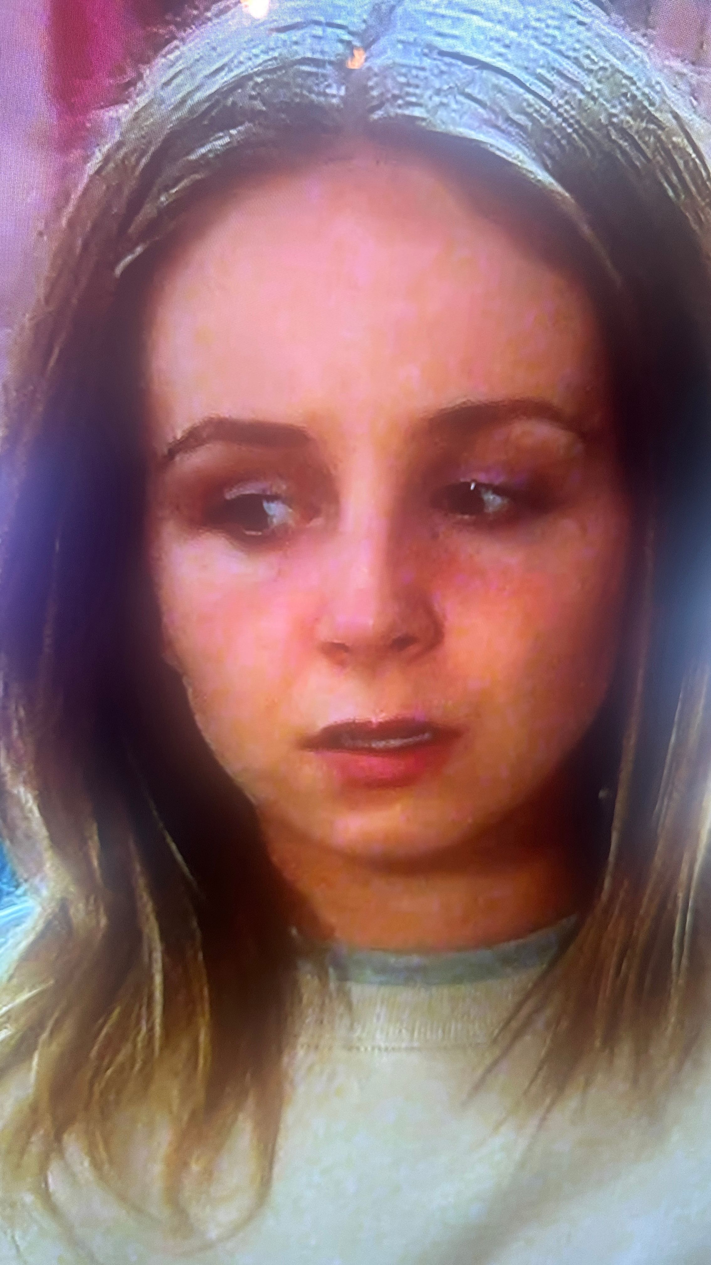

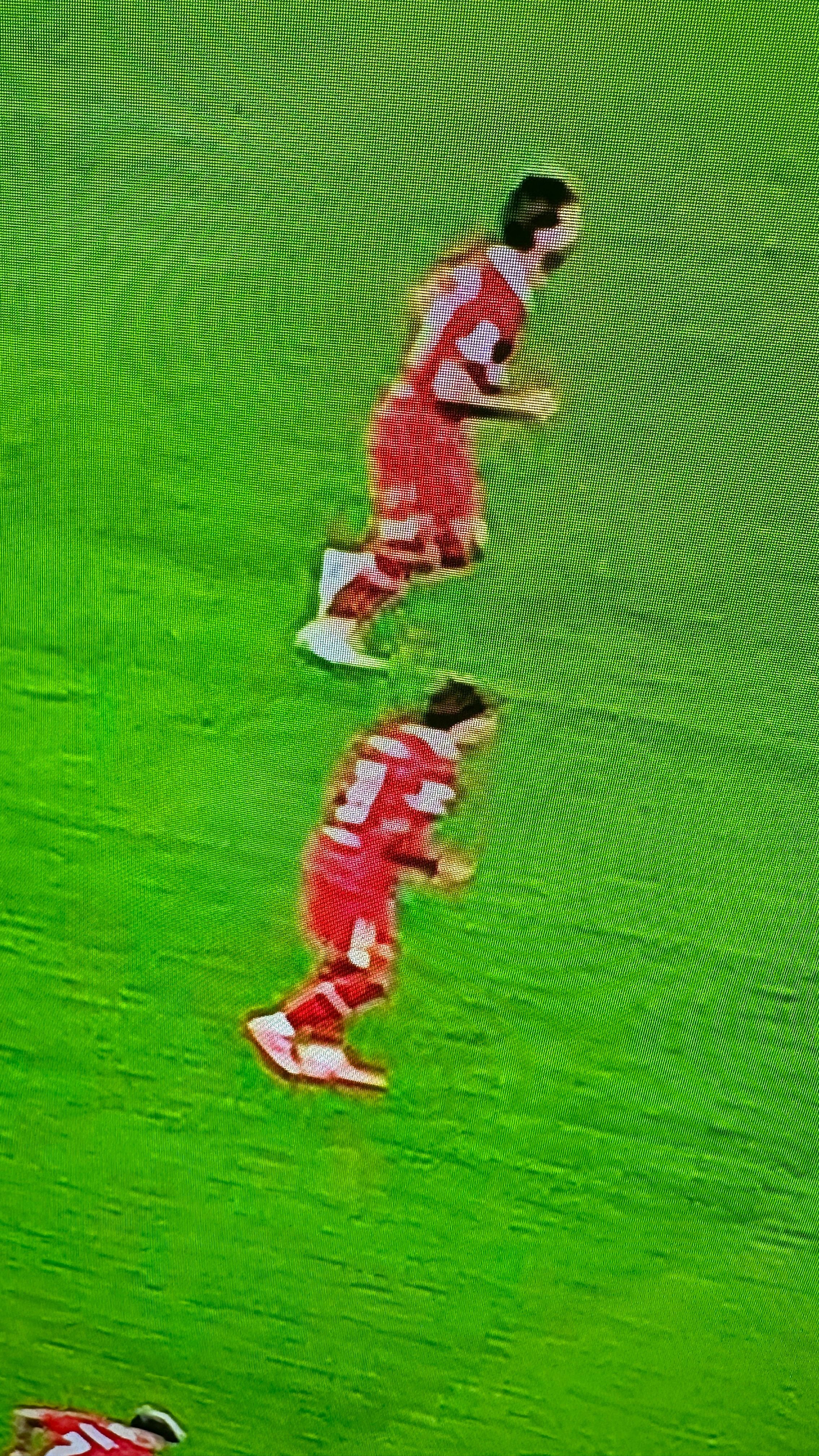

As the title suggests…. Have really poor picture quality across all channels. I had poor picture quality on my old TV and stupidly thought it was my TV which is why I had such bad quality so purchased a new LG OLED TV and no difference at all.
My dad has a 10 year old basic TV and is with Sky and his picture quality is exceptional.
All HD channels are like watching SD, I’ve tried amending the resolution on the settings which makes no difference. Only time I get a good quality picture is when I’m watching on one of the apps such as Prime or Netflix. Few pictures of the picture quality I’m getting - all of this is on HD channels.

  • Sorry to jump on this thread as I am interested in this too, as I have the same issue as you. Treat myself to a top of the range OLED LG TV too and the picture quality is just awful with virgin! My dad has a 10 year-old telly from John Lewis and use the sky and the picture is like watching in 4K. This was in HD watching the MotoGP this weekend with virgin. Truly awful!

  • Sorry I know I’m not the original poster but assume he’s having the same problem as me, my TV picture is awful even in HD - the picture I posted above of the Moto GP was from the TNT HD channel!

  • Anyone able to assist? This is the football this evening in HD.
