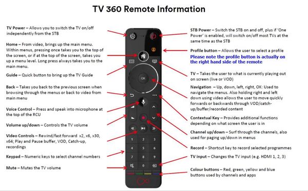

  • Assuming set up for that TV, the button on the bottom right of the Virgin remote - the box with the arrow into it - changes the TV's input. Press that and then the arrows and select to get to the right HDMI input.
    • FortyTwo's avatar
      FortyTwo
      Thanks - got it and seen it and that must be it - WHY? she stabs at random buttons making random changes that she has no idea what why and when beggars belief but   . . . .
        The picture below explains the functions of the various keys on the 360 remote.
