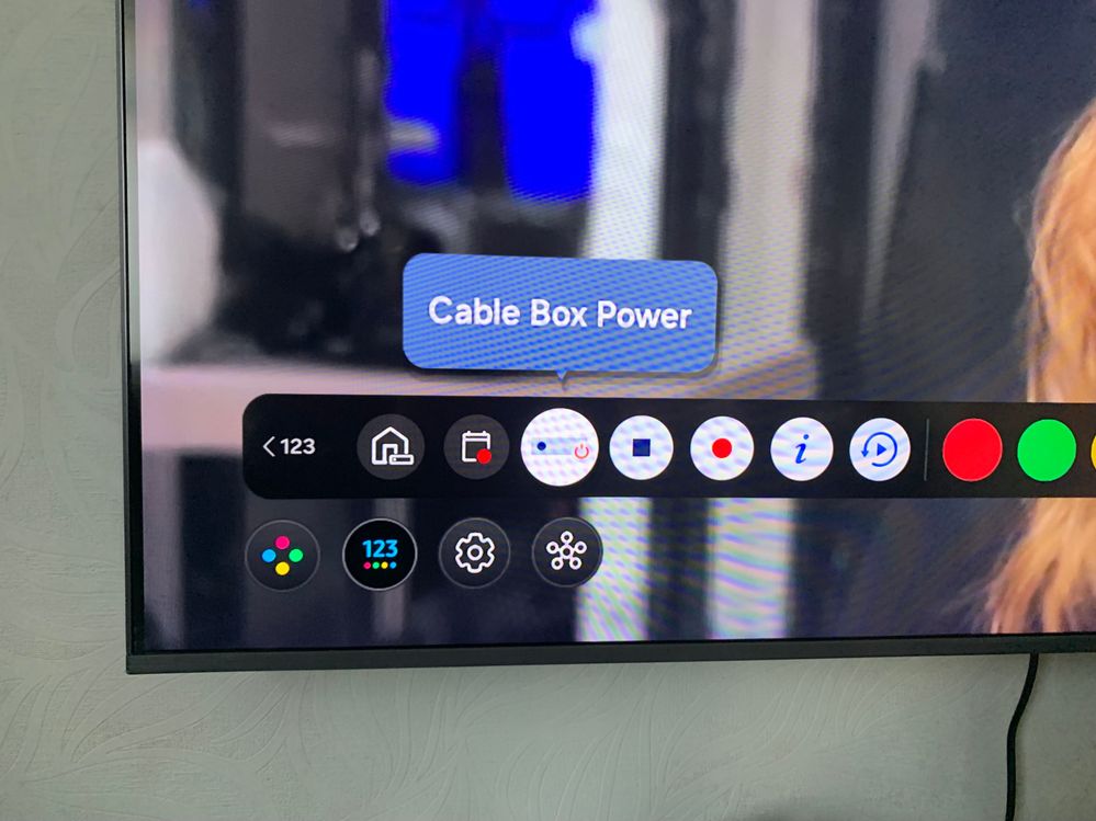

      • HobGoblyn's avatar
        HobGoblyn
        Thanks Vikki
        It’s definitely Samsungs problem and it’s a very strange setup
        As I said, their remotes Power button happily turns on the 360 box but won’t turn it off.
        But, the Samsung comes with two remotes, one with tons of buttons, the other a much smaller remote with only a handful of buttons.
        On the smaller remote there is a button with 123 and 3 colour dots on it. Purely by chance, I discovered if I press it and scroll fully to the right, I’m presented with an option called “Cable Box Power” (see pic) and selecting that does turn the Virgin box off.
        So the Samsung can do it, they’ve just made it very tedious, far easier to keep the Virgin remote out as well.
        Many thanks
