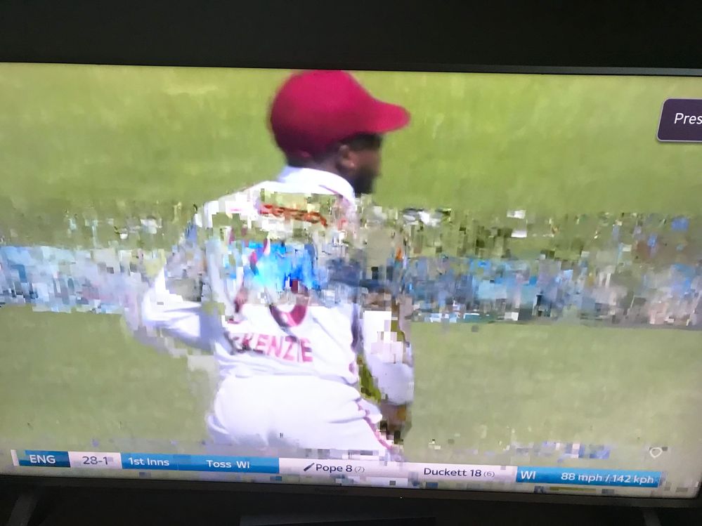

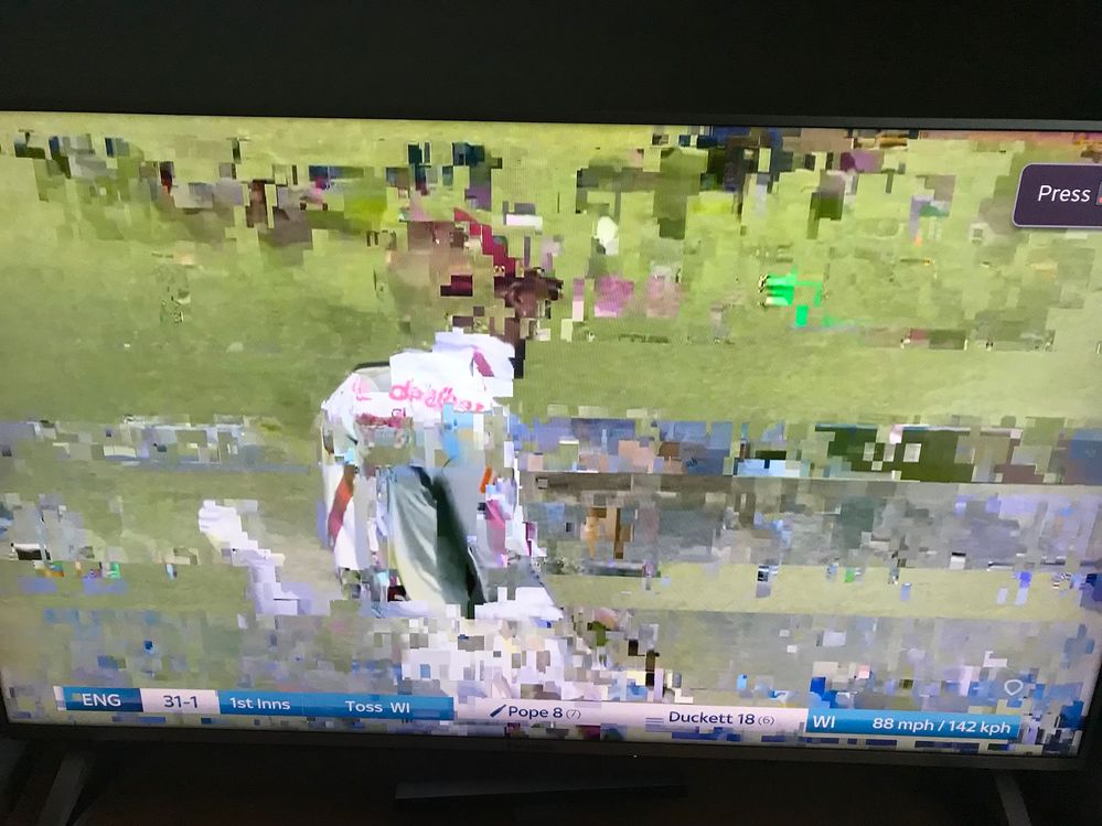

Not having the SD alternative is problematic as every now and again the HD Channel goes on the blink. Currently the Cricket looks like this (was fine earlier). I would record both SD and HD variants to guarantee I could watch a match.
It is totally and utterly bonkers. If I watch the stream from earlier, it is perfect. If I watch the stream of the current broadcast, it is defective! Just checking and the stream starts to be defective at 8:45:10. In the past I was told it was my box was the issue, but unless a 9 hour stream is stored on my box, that cannot be the case.- G4DDSWell-informed
I think this is a national issue. Mine is doing this along with 527 and 104 all pixelating and breaking up. Also reports from Edinburgh area that 103 and 104 are breaking up.
For mine, I've checked diagnostics (on V6) and there are no RS errors indicating its a problem with the broadcast /transmission and not a local signal issue.
Update: Service status on the app is reporting the breaking up issue and it now appears to have been resolved at least on my setup.

arrgee1991 wrote:Not having the SD alternative is problematic as every now and again the HD Channel goes on the blink. Currently the Cricket looks like this (was fine earlier).
That's a service fault all day long, if happening on the live TV feed.
Check Eurosport-2HD, Sky Family HD, Sky Comedy HD, TLC-HD, Quest HD. These are all on the same broadcast mux and would be equally affected by a signal fault.

Watching Sky Sports Cricket. See below. In the past I could switch to SD. But with 360, it is NOT POSSIBLE!
Why isn’t the SD Sky Sports available? I would be better off without the HD upgrade.Cant watch live darts, can’t watch rugby, can’t watch cricket, can’t watch F1, can’t watch racing, can’t watch Sky Mix, can’t watch TNT 1.

Almost all problems occur between your box and cabinet, with a large percentage within the home itself (e.g. dodgy cable connections, faulty box, faulty splitter, faulty cable). However if none are applicable and you only get pixellation on channels of a particular mux, then the problem probably needs to be resolved at the central headend if stat-muxing isn't working properly.

It happens a lot with Sky Sports HD. All fine when I am there watching it, but recordings in interim mysteriously unwatchable. I then try test recording, all fine. I turn box off and on again yet every now and again the same thing happens. So on V6 I recorded sports on main event Hd and SD along with premier league HD/SD. Ditto TNT recording UHD and HD. At least this time the ropey stream proved it wasn't my box. Not much consolation though as I didn't get to watch cricket highlights.

Roger_Gooner wrote:However if none are applicable and you only get pixellation on channels of a particular mux, then the problem probably needs to be resolved at the central headend if stat-muxing isn't working properly.
Indeed so - but worth reinforcing that problems at the central or regional head-end will affect all boxes downstream of that.
Such faults tend to attract widespread attention and cause large volumes of posts on this forum. The majority of signal faults are caused by issues either in the streetcab or downstream of that.
