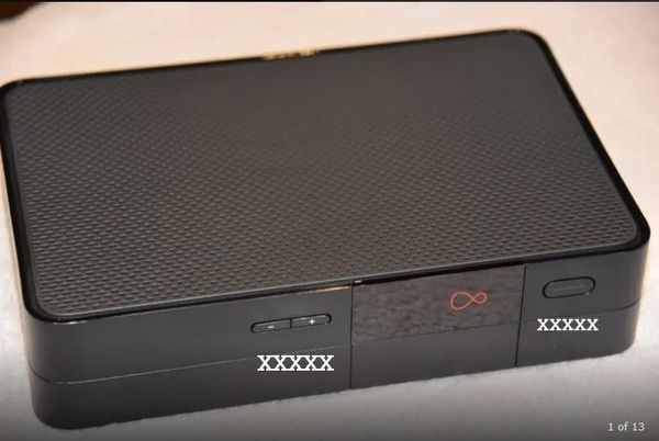

      Hi again Mandyleed50​
      Going back to your first post in this thread you say, 'Reset numerous times to no avail so rang Virgin who told me there is and to wait another 48 hours. It is stuck on the welcome message so I don’t even now have access to live tv. '
      What method(s) have you used to reset the 360 box?  Since you are stuck on the Welcome screen  try turning off the 360 by the switch on the back of the box;  then on the front of the 360 box  hold down both the standby/power button and the - (minus) button at the same time. Then turn on the 360 again whilst keeping hold of those buttons for a further 30 seconds.
      If the standby/power button and the -  button workaround doesn't solve it then try using the standby/power button and the + (plus) button at the same time instead.
      • Mandyleed50's avatar
        Mandyleed50
        Thanks for your reply but I have done both. So I have shut everything off including wifi, unplugged it, turned off and left for 2 minutes plus, used initially the on/+ plus button and the with the - button after reading that on here. Once it tried to boot but never worked and ended up back at the welcome pa
