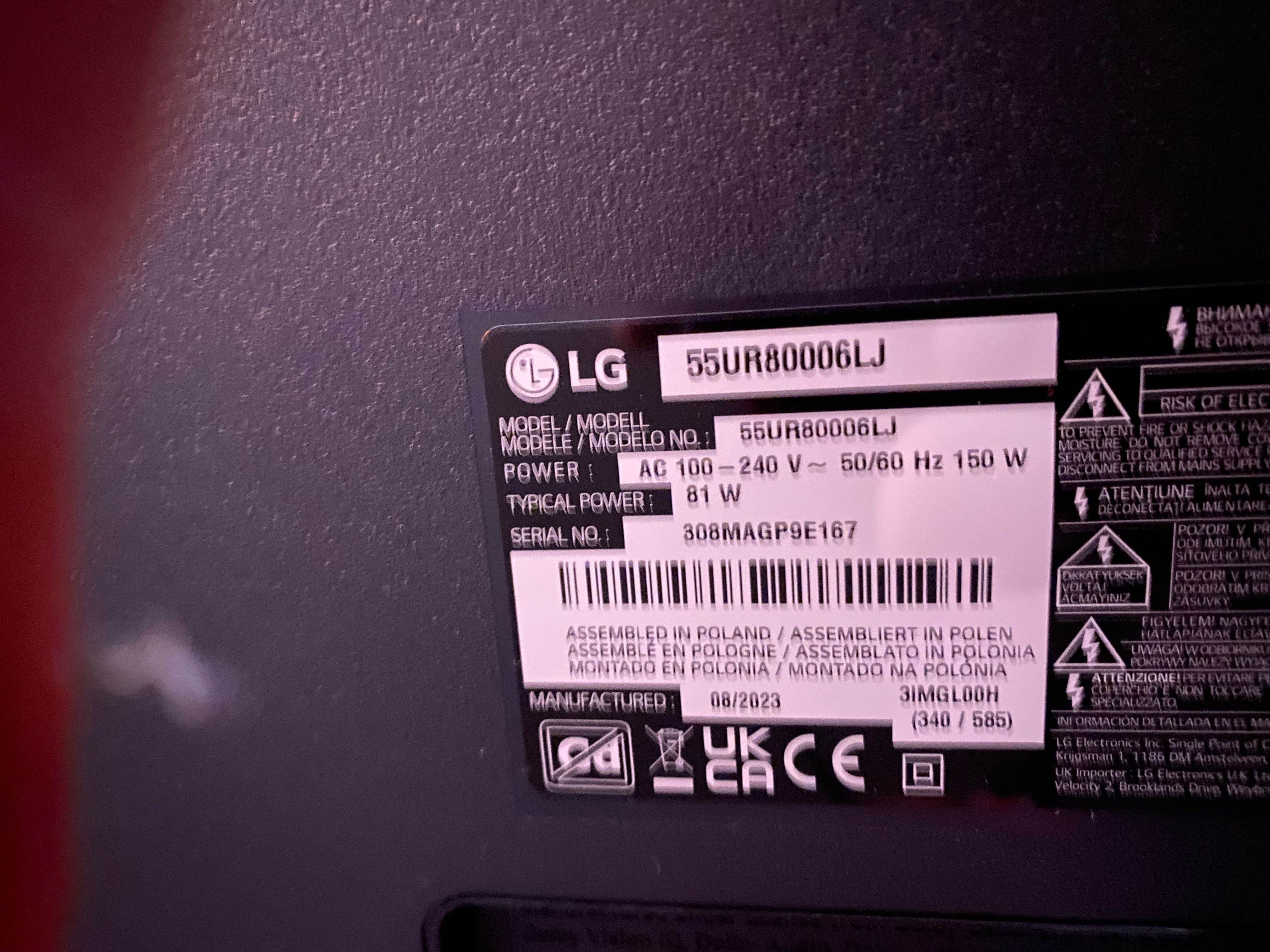

I’ve tried every option I can think of, the box resolutely refuses to recognise TV and soundbar…the key tests don’t work, and I’ve tried all other variations of model numbers none of which are recognised. I’ve factory reset the box, reset the remote several times all to no avail. Am I connected properly? My TV is an LG 55 UR6000LJ about two years old. In TV settings I’ve made sure the right option is selected for audio out, nothing thus far has worked…

    Please can you confirm the TV model. I can't find any match for  LG 55 UR6000LJ using google search.
    If it's a NANO then try typing NANO as the model, if it's an OLED then try typing OLED as the model.
    I have an older LGNANO796NE and was able to set it up by typing NANO and also by typing 796E, so double check your model number and also try typing in the last 4 characters.

    No worries with the mangled model number, it happens very often.
    I take it you've tried to pair the 360 remote by holding down the 'TV' button and '0' button together until the Standby button starts to flash.
    Please try entering the following for the model number UR80, if that doesn't work try 06LJ, and if that fails then try 8000
