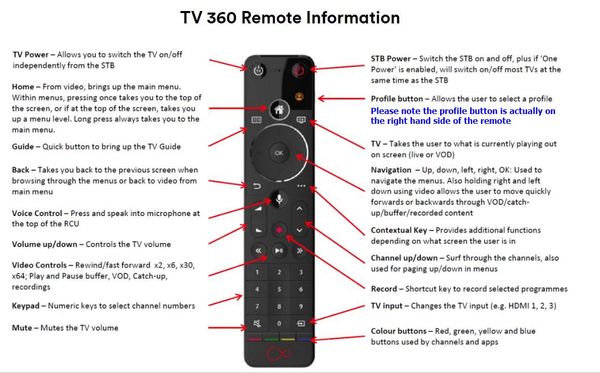

    It sounds like you already have the new 360 remote as that doesn't have the 'Clear' button. The 360 remote has a voice button and is rectangular in shape, unlike the tivo and V6 remotes which are peanut shaped and have the 'Clear' button.
    Since you've received the new box indicated in the emails to get the 'free upgrade' to a 360 box due to Netflix being no longer supported on my original Tivo box;' you need to remove the tivo box and plug in the new 360 box and follow the instructions shown from section 2 page 15 onwards in the following link.
    https://assets.virginmedia.com/resources/pdf/TV360.pdf
    Below is a picture of the 360 remote

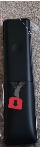

        The TV360 remote has a plastic tab in the back which needs removing so the batteries can make contact and start working.  Even though it's a new remote you might need to change the batteries.
