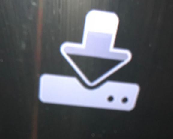

    Is there anything at all showing on the screen such as an error code/message, or an icon like the one pictured below (it's like an animated down arrow/floppy disk) ?
    If there is a screen like that showing it's possible to get it up and running again by  turning off the 360 at switch;  then on the 360 box  hold down both the power button and the - (minus) button which is on the front of the box at the same time. Then turn on the 360 again whilst keeping hold of those buttons for a further 30 seconds. The box should reboot, the power button will turn blue, and it should reset and boot up normally as a 360.  Again if it's showing that screen and the above doesn't work then use the same method but substitute the minus button for the + (plus) button
